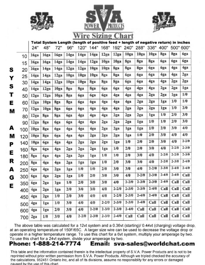

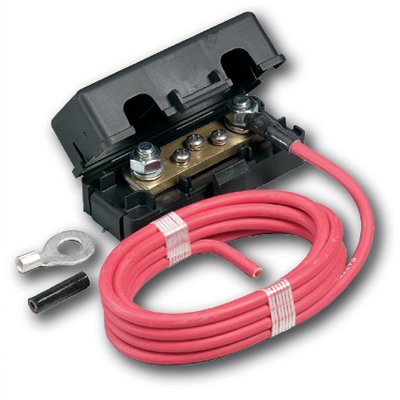

I did the same, if going with a one wire there isn't much you need to do other than size the wire from the alt to the battery correctly for the 100 amps. How are you wiring in the additions? The factory harnesses don't have a very big main feed so I'd recommend a pos junction block to power the additions. Yes, if running an ammeter 100% of the current has to go threw it in order for it to be accurate "you don't want 100 amps going threw it". A voltmeter is the way to go anyways with the ammeters being fire hazards anyhow. Wiring the voltmeter means just finding a 12V source and hooking into it. You do not need to change the bat to the starter cable "they are huge and are made to handle allot more than 100 amps". WiresizingchartBW.jpgJB-57-Md.jpg

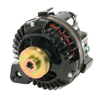

Are you only recommending using an external regulator for looks? I personally prefer internally regulated alternators for they're simplicity and reliability but then again I don't care about originality. Here is the alt I used, it's a Tuff one wire from Summit.tff-7509resp_w.jpg
Are you only recommending using an external regulator for looks? I personally prefer internally regulated alternators for they're simplicity and reliability but then again I don't care about originality. Here is the alt I used, it's a Tuff one wire from Summit.View attachment 161993
I used the one I recommended purely to save on more wiring loom modifications, and to keep the stock look. It really is personal choice, and if the car is not built to be a stocker, any alternator would work fine.
Just showing what I used and works for me :)
Thanks, I was just curious.
