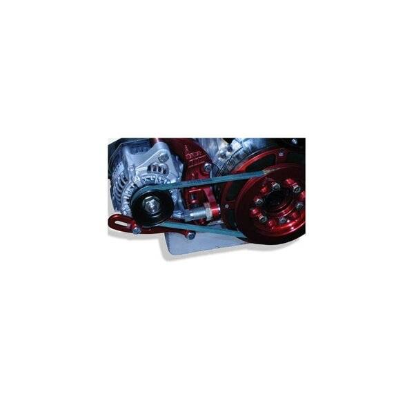

The alternator is run off the crank with a special bracket setup and single pulley i bought years ago on my 470 stroker.... I think they are still available, but I gotta find you the name..(EDITED)...
Low mount alternator bracket Mopar Big Block B/RB Hemi, billet aluminum. (dotymi.com)

View attachment 1107064 The alternator is run off the crank with a special bracket setup and single pulley i bought years ago on my 470 stroker.... I think they are still available, but I gotta find you the name..(EDITED)...
Looks good! I need to study the photo some more. The issue I may have is that I am running a right outlet pump. I had to do that to make the radiator work when I put the 440 in my '87 D150. It was originally a 318 truck and the radiator has a right hand lower outlet. Don't really want to have to change the radiator to make it work. Guess if I bought it and it didn't work I could use it on another project. I noticed that the photo shows a small toyota style alternator. I wonder if that is mandatory with this bracket?
Cant remember for sure, but i did go with something similar. Actually the desire was small, light, and one wire hookup... I had no need for originality, and the Mopar style alt is quite heavy and bulky. On mine, we did'nt use his dog-bone either, because the alt itself could mount right thru the front plate to the block. A quick phone call to Doty should give you the right answer. HTH, Lefty71

Bummer, I just checked and the dotimi.com bracket requires an electric fuel pump as the alternator blocks the fuel pump.
Sooo...., still looking for a solution.
