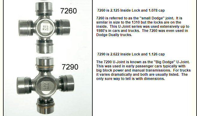

8 3/4? Which center section are you dealing with? There is the bog yoke and small yoke for those years if someone swapped the center out for a 489 or something like that situation. Stock joint should be a 7260 joint. 489 carrier would have a 7290 joint which is bigger I believe 2 5/8" vs. 2 1/8"....

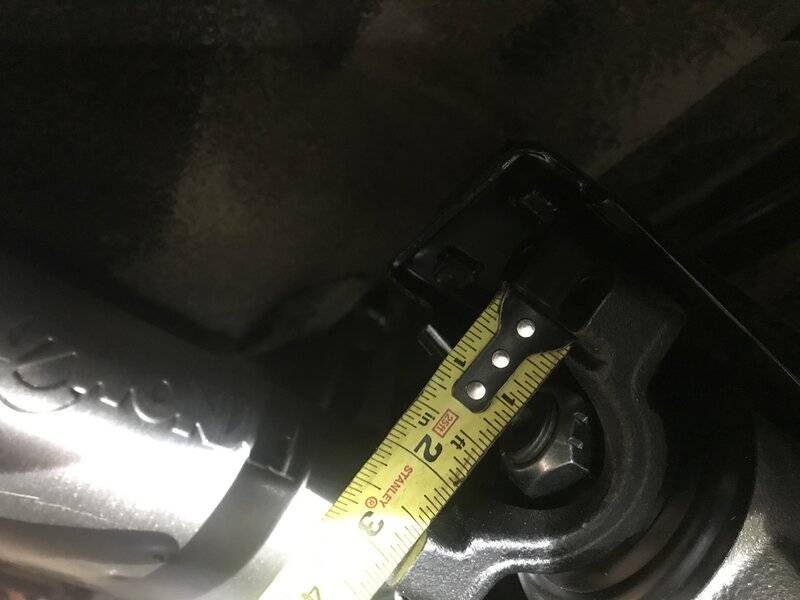

You sure it isn't a 7290 on a 489 carrier? That is what would have been standard.....What is the distance from outer cap/groove to outer cap/groove on the yoke? The cap size on the 7290 is 1.125 and the 7260 is the smaller 1.078. If your span is 2 5/8" and the cup size is 1.125 then you have a 7290 yoke which would be standard issue on a 489 carrier.
Moog #s are 315 for 7260 and 316 for 7290 IIRC. RUFFCUT

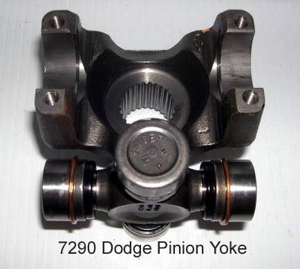

The reason I ask is his website only lists 7290 and 1350 u joint yokes for the 489 third member he sells. And if it turns out to be a 7290 joint then check your driveshaft first before ordering that joint......if its a small yoke on your driveshaft but a 7290 yoke on the rear end you will have to order the conversion joint which has the small span smaller diameter cups on one side, and the larger cups and span on the other to make the combination work.
The reason I ask is his website only lists 7290 and 1350 u joint yokes for the third member he sells. And if it turns out to be a 7290 joint then check your driveshaft first before ordering that joint......if its a small yoke on your driveshaft but a 7290 yoke on the rear end you will have to order the conversion joint which has the small span smaller diameter cups on one side, and the larger cups and span on the other to make the combination work.

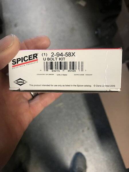

This is what I got with it.
Do you have the paperwork from Cass? Sure looks like a 7290 yoke to me. That is why your 7260 joint wont fit the cup span as its only 2 1/8" wide and made for the smaller yoke. Now what is your driveshaft end like? If it is setup for an original u joint it may be the 7260 smaller span which means you will have to use the conversion u joint. I have that one in my Charger as the driveshaft was from a 383 car but I used a 489 pinion and yoke.
Driveshaft is definitely larger also. Both of the U joints sets that I have ordered have been two small diameter and slide right into the driveshaft. It was a an original 489 case so I’m positive it’s the larger ones now.

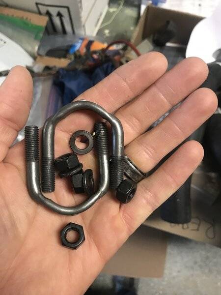

That is not even close to correct. The stock U joints for a 489 case use a strap type. Those are for something like 1330 or 1350 style joint. Get your measurements and call Cass.
