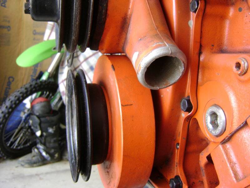

Fluidampr (non recessed) with a stock appearing aluminum water pump housing. I spaced the crank pulley with a spacer from 440source (127-1005). It may have been a direct fit with a stock iron housing, but I never tried. The timing marks on the damper aligned perfectly with the timing tab on the stock cover which came from a '77 400. The pump pulley was from a '73 440, the crank pulley came from ebay, it looks like 440source has pulleys though, in both single groove & two groove. I don't have a part number for the damper, it was used. I bought it from member HT413 a couple years ago on this forum actually. You can source the same water pump housing from Mancini Racing (MRE86900).
Thank you very much. That’s exactly the info/pics I’m looking for. Would you believe I just sold one of those fluidamprs last month.. Oops. Thanks again !
