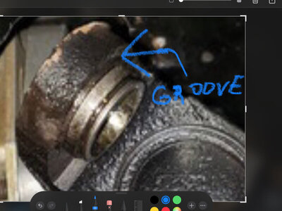

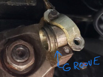

Question, the caps that are in the rear yoke and trans yoke, are there clips in the grooves? Look at the driveshaft also. There are clips on the inside ears and they need to be on every cap of both u joints. = all 8 caps

wuestion, the caps that are in the rear you’ll amd trans yoke, are there clips in the grooves? Look at the driveshaft also. There are clips on the inside ears and they need to be on every cap of both u joints. =8
View attachment 1141107 View attachment 1141108
This is your answer... Seen it a few times... Lotta damage every time but yours is about as bad as I've seen..
I'm betting on the missing C clips as well.

If it's not obvious, this part was not done right. Likely the C clips as others have already mentioned.
With no clips, I think it spit a cap on the rear joint. That put the drive shaft out of balance and allowed remains of rear joint to flail around until everything broke. Sorry to see this.
I lost a driveshaft in my early years of racing. It let go at the top end and scared the sh## out of me, same carnage. I had changed the rear u-joint and forgot the retaining clips. Expensive lesson, but I never forgot them again.
Damn that's a lot of damage. I agree that it looks like it all started with the rear u joint yoke connection. The C clips are a must to hold the u joint in position. 440'
