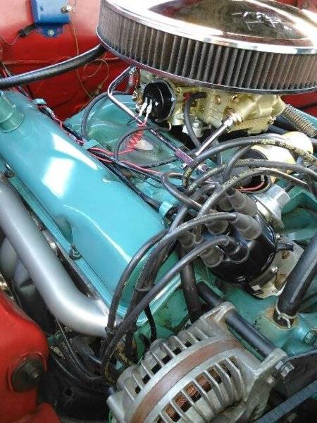

Sonny RB Block, 750 HOLLEY DP Mechanical Secondaries...E choke..2 summers, no prob...J/S...

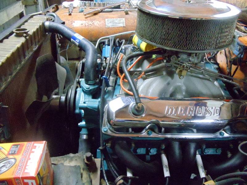

850 Mighty Demon. Perfect under 8000 feet and 101 degrees. Really easy to tune, and sweet 2-4 transitions.
