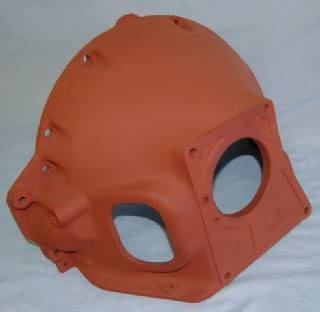

If I am not mistaken, the number should be stamped on the outside front, technically the back of the bell housing towards the bottom right if you are looking at it. Sorry if that is a little confusing. Let me see if I can find a pic. Looking at the pic below, it should be at the bottom right.
Thanks....that makes sense. Looks like I'll have to take my tranny off the bell.
