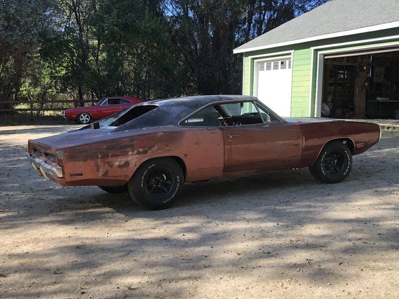

I'm preparing myself for the sticker shock.
I'm going to need new exhaust for the '70 Charger I'm screwing together. I have headers but need everything back from there. I figure 2 1/2" pipes, an X pipe center section, decent mufflers and tailpipes. Nothing exotic.
I've seen kits online under $800. Can that be right? It has been awhile since I had a full system done.

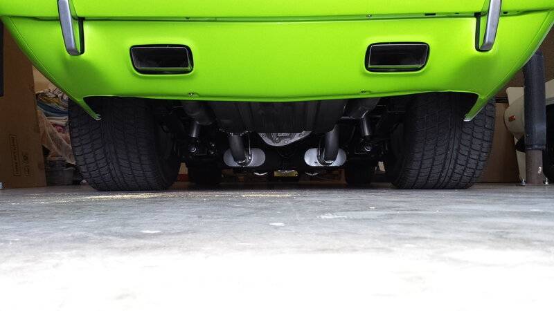

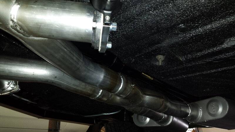

This was probably our most difficult one. 70 Cuda, tubbed with inboard springs and 3" pipes going over a Dana 60, X pipe and electric cutouts. Had to modify the tips. Think this one was over a grand but this wasn't a normal setup.
Stainless with polished mufflers? Whoa...have you seen the car I'm working on?
