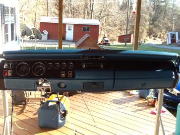

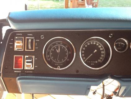

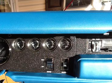

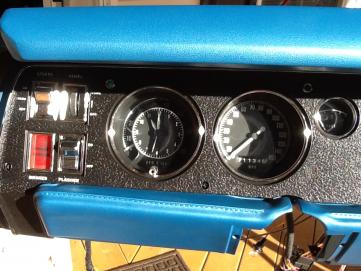

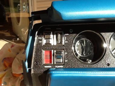

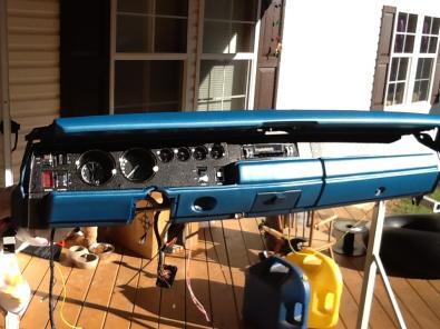

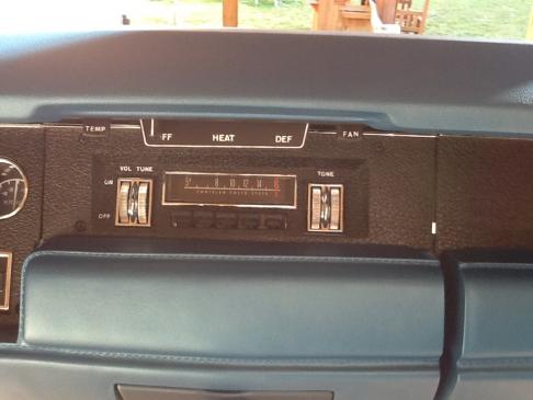

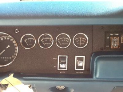

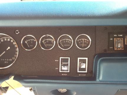

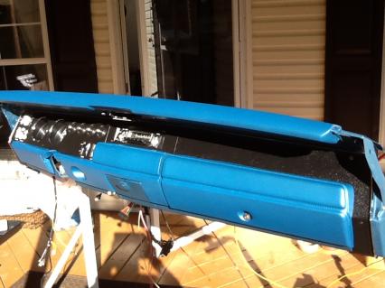

Here's some pics of my dash. I have did every piece except replate the plastic trim. someone had changed it over to black so I'm in the process of doing everything in blue which is how the car came new. Blasted and painted dash frame and restored the vin tag. Serviced all the instruments
including cleaning, refacing and calibration. reworked all the switches and been completely through the the harness and replaced a bunch of Packard terminals. still looking for some original dash vents and waiting for some fiberglass braided sleeving to come in so I can finish up the 3 speed wiper motor
restoration and in it goes. I have completely restored the heater box will post some pics of it next. Anyway what do you guys think of the dash

That looks fantastic. It must feel great just to look at it after all the work.
that is very nice WORK,how long do you think you had in it. and is that b5 and b7 color?
Yea B5/B7 I hate to think of the time I have in it but it's at least 40 hrs. I repaired the clock also I re wound the pickup coil
Thanks for all the comments guys I had to share with someone besides the wife!
Great job, looks brand new again.
