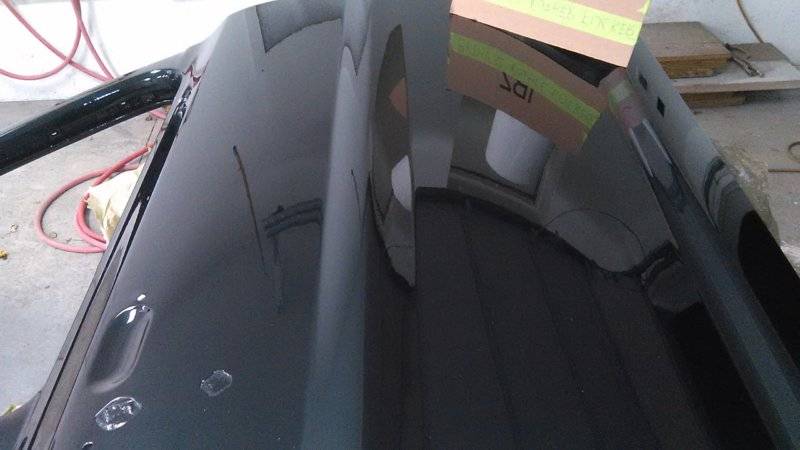

a "high speed" buffer is what I call a grinder...... if you're buffing clear coat, you're probably gonna want to do some sanding first........ 2000 grit wet will get you where you need to be safely, 3000 wet on a DA after that will lend to minimal buffing but not necessary........ I prefer more sanding and less buffing; but be careful on the edges the DA and buffer can both ruin your day. run that **** slow

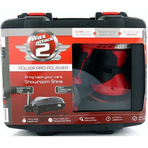

Since we're all dropping product brand names...I use the mothers wax Attack palm polisher.
Virtually idiot proof...so anyone can use it without fear of ruining a clear coat. Expect to pay more than $30 for the kit. For $30, you might get some rags and a small tub of polish.
