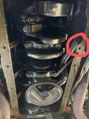

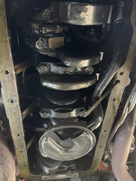

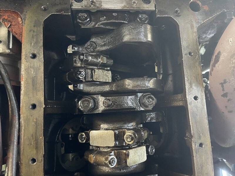

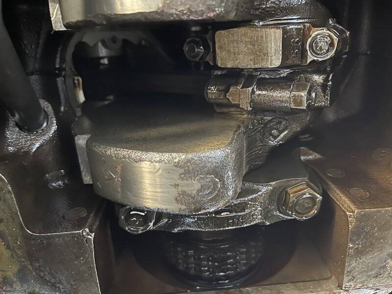

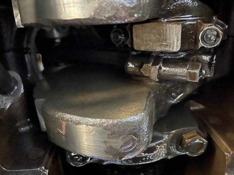

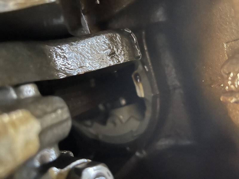

Removed my oil pan because I have a pretty bad leak. Seems like there’s a crack on the pan for it to leak that bad but I can’t find any cracks and it is oil but maybe it just is a bad gasket
Anyway while I have the pan off here’s what’s inside.
Anything you see ?
I did notice the cam is purple why s that ?

$$$$$$$$$ and a crack. :(

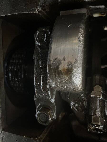

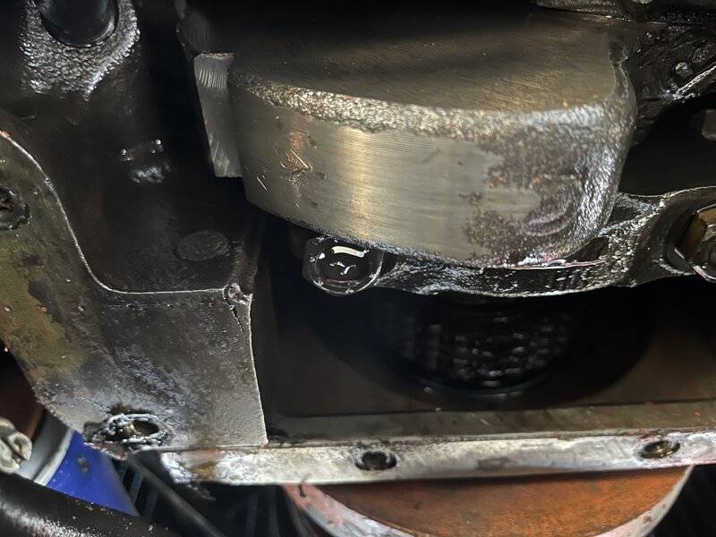

Well it was either scraping those crank counter weights or they balanced the rotating assembly and took off some weight. Not real sure. Any indication that it was hitting the block anywhere? Also replace the rear main while you have it down that far.
Nothing on the pan that indicates scraping or any noises heard
car runs great, psi at 45-50 once warmed up
Is your oil pickup tube rubbing the pan rail?

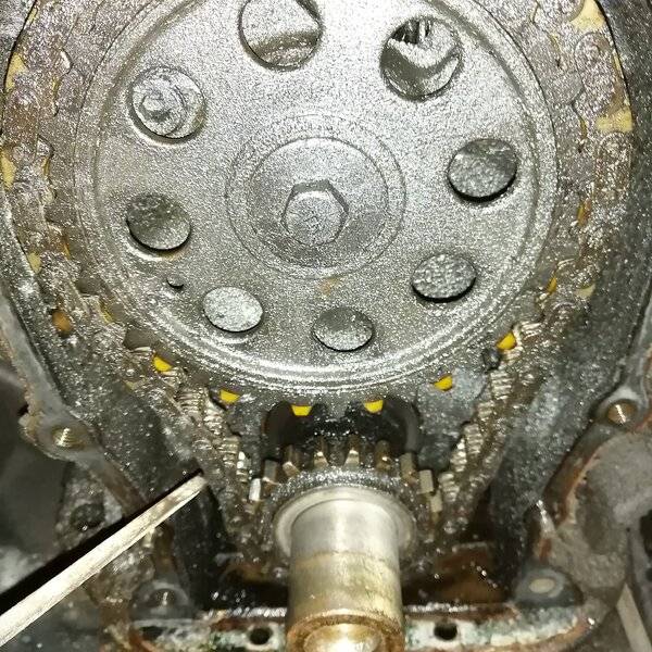

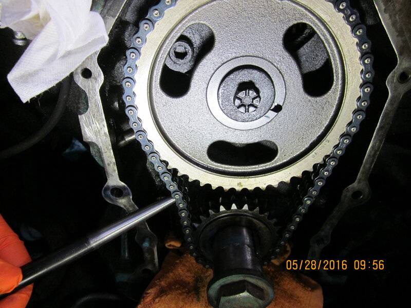

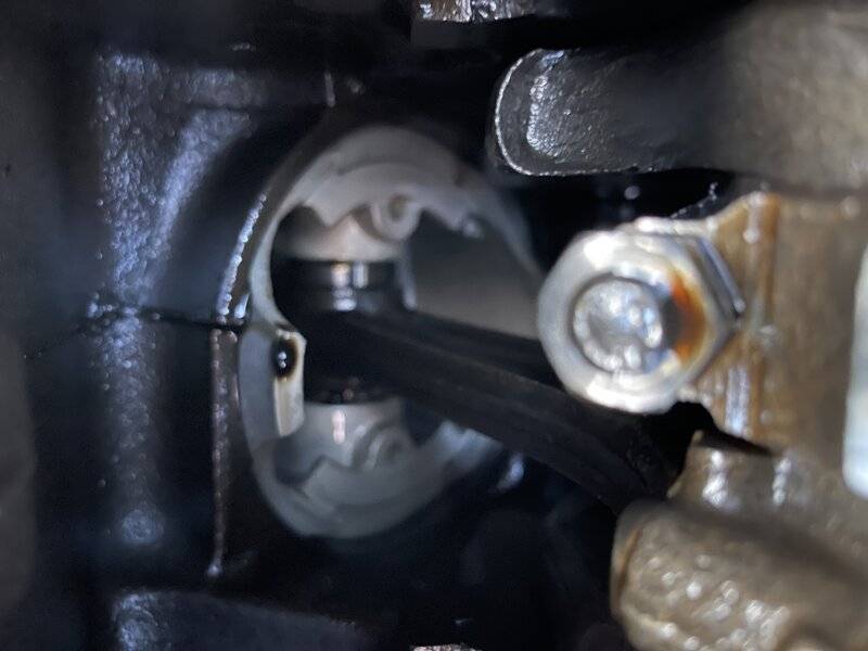

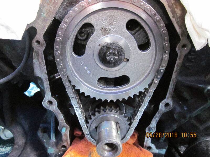

You're running a silent timing chain instead of a double roller?
I see a timing chain
Let me get a better pic
excise my ignorance it’s my first mopar big block

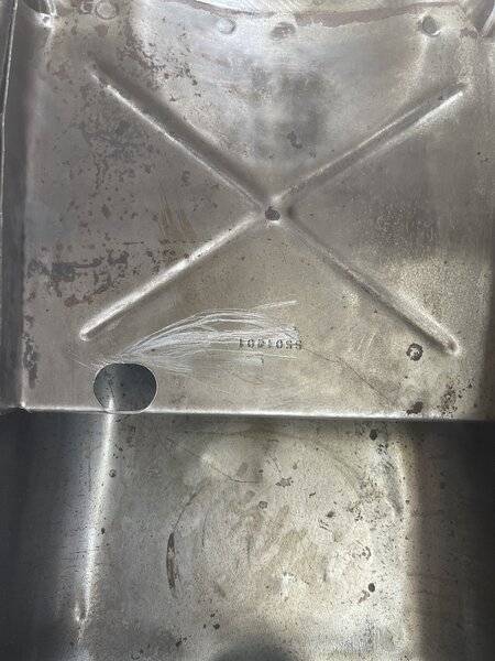

Those scratches on the baffle look like the dipstick was missing the hole. Definitely a silent chain, like mine came with. I would change it. Mine was pretty streched. Did you find any nylon pieces in the pan?
No no pieces of anything
what’s the silent chain ?
I was actually worried I’d find something because it was just too easy
everything in this car has been pretty easy
No broken bolts, no stripped threads, nothing and so far so good. I’m always waiting for something to happen lol
Thanks
