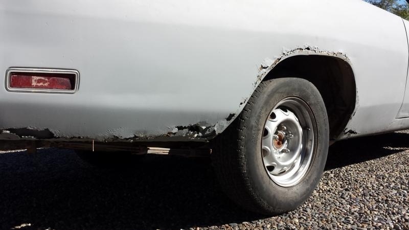

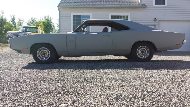

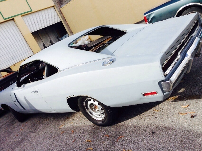

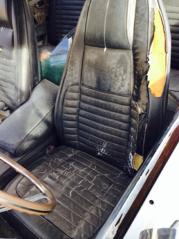

Hello friends, I´m very excited about beggining the restoration of my 70´Dodge Charger. It´s a dream came true and I have worked very hard to achieve it, but I have got some doubts about how to do it, so any help is appreciated...
The project idea is to do a mild restomod. Now, I´ve got some money to start, near 20k (not the total amount I would need to finish it), so I´m deciding what to do and in what order...
I would like to paint it at the end, but I don´t want to spend inncesary money doing things twice...
I already bought all what I need to rebuild the engine, so I was wondering to do this:
1) Do all the metal work, repairing all the oxid. Paint the interior, underside of the car and the engine bay in black.
2) Install Hotchkis TVS Sport Suspension kit (http://www.hotchkis.net/product/197...sport-suspension/?mk=40&yr=1970&md=287&sm=295)
3) Upgrade brake system
4) Rebuild the engine
And in the second "stage", I would do:
4) Exhaust system and transmission.
5) Windshield, glasses, lights, electrical system and interior.
6) Paint the car.
7) Any other remaining things...
The big question is...do you thinks that´s the right order? would you do it that way? Any advice is more than welcome.

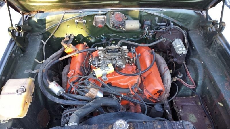

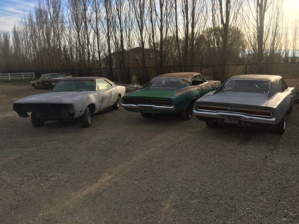

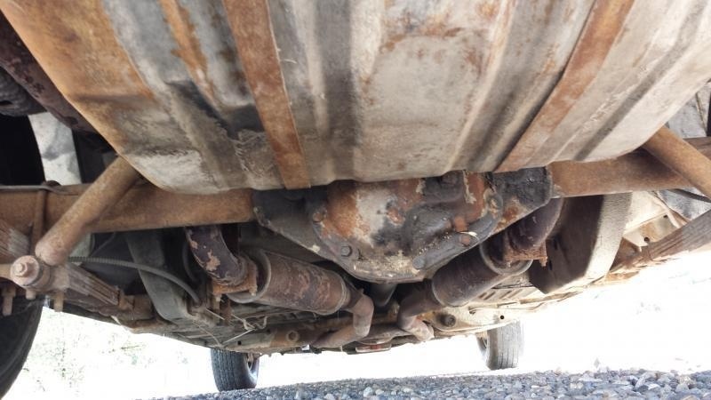

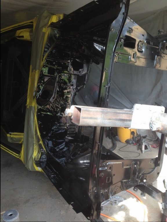

First picture is what I have in mind... The rest are actual photos of the car.
Thanks in advance!!

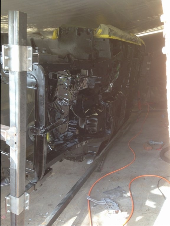

After learning from mistakes, I've began to put them on rotisserie. Strip completely and go from there. If you are building to keep and not sell, it's the best way to start. No regrets

Rotisserie is the only way to really go and get that car to bare metal before you paint.Paint first then put back together.Thats the way mine was done. Came out great but takes alot of time...

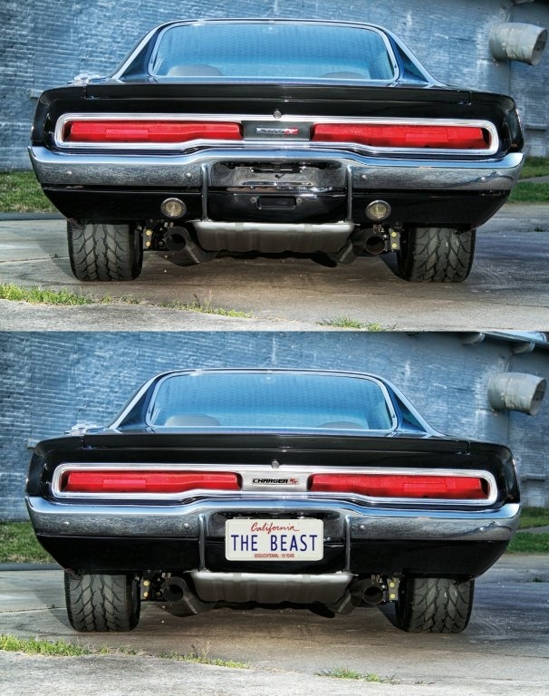

My idea is a mild restomod: visually classic (wide 15" American Racing Torque Thrust II wheels, painted black with red stripes) but with new technology (air conditioning, good audio system...) and modern driving behavior (upgrade brakes, suspension...)

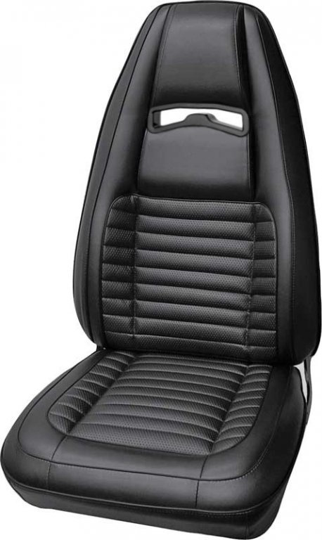

I will also do little customization in lots of parts: seats, lights...For example, I would like to transform the original seats into sport ones, modificating them and adding harnesses...

Yes!! Like that one, but with other wheels and a few changes in the rear: I will use modify the tail lights, using one of a 70´Challenger instead of the round original ones; bumpers will also change a little bit (no gap between the body and the chromed bumper) and its name will be "The Beast".
Summarizing, something like this...
You've got a good plan - some great ideas from the FBBO crew and a beautiful car to start your project with. I like your pics of what you expect to end up with. It will definitely be a "Beast". Good luck and keep us in the loop with a progress thread.

My vote is always do the metal work first. Sometimes looks are deceiving. If you cant get it blasted, even chemical stripping will do. You mentioned being on a tight budget. You are better off knowing what metal work is really needed. You might strip it and find that floor pans, trunk pan, quarters, sail panel, trunk lip , etc may be rotted. Body work can easily blow that budget if you find lots of pinholes, rust, hidden damage.
