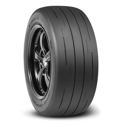

M/T 315/65x15 ET street radial pro, on an ex-8sec car, to replace 18.5/31x15 Hoosier quick time pro. Little tires for big.

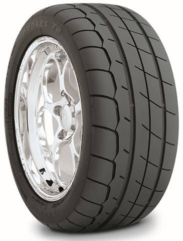

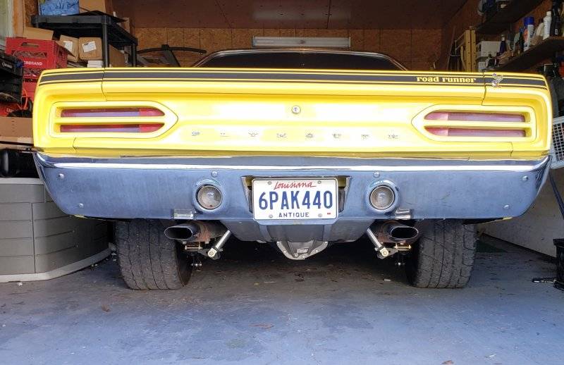

Toyo Proxes TQ drag radials...
On Year One aluminum Rallye wheels rear wheel diameter 17"x 9" wide, 5" backspacing. FACTORY stock suspension, wheelwells, etc at the time, 315/35/17 and perfectly centered, ZERO rubbing! GREAT wet streets/rain performance and good on the track. If only the factory could have used these, they sure would have fit like OEM.
I've since done some suspension mods, all in my signature. I'm going to try the 345/40/17 and see if they fit.
I'd NEVER use Nitto 555R drag radials if there was ANY chance of encountering a wet surface, and if I had Nitto 555R on and it rained? I'd have to call a tow. My 1st hand experience with the Nitto 555R, good to great tread depth, on my 89 Conquest TSi could have killed me in a medium-light rain at 60 MPH on a 70 MPH limit highway blacktop in great condition.
I have complete confidence in the Toyo Proxes TQ drag radials if I happen to get caught in rain.
Unfortunately I haven't been to the track since I had numerous traction aids installed, but I believe the Toyo Proxes TQ drag radials are very good.
I'm also interested in trying some Mackey Thompson stuff, but I have no 1st hand experience.
For street and strip?
Hands down, 100% Toyo!

The M/T radial pro's are not street legal, even though they have a Dot number. They are basically radial slicks with the absolutely minimum tread. My giant Hoosier are street legal, but neither should EVER be anywhere near a wet road!

What car?
70 V-code Roadrunner
These are them...

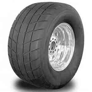

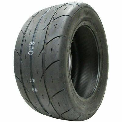

Of these two which one? Both 275/60/15 These are the only ones in stock right now. MT or M&H
Thought I had a pic of the M&H it has tread on the outer sides
If you're buying it more for street use, the more open tread of the M&H. If you're buying for strip use, and occasional street use, get the mickeys.
The mickeys can be lethal in the wet, they are race tires, and certainly won't last long regularly street driven..
Edit: the sipes(sideways grooves to direct water) on the M&H make it a bunch better street tire.
100% street and probably 500 miles per year. M&H it is
Mike,
I'm going to post again for emphasis, since you just wrote that you are using the drag radials for 100% Street use, please, for your own safety, look at the Toyo Proxes TQ drag radials.
IF you hit wet surfaces, puddles, or rain, they are WAY more safe, I'd say the safest drag radials in wet conditions, and work well for traction.
The smallest diameter is a 16", I use 17". If you have to have 15s I guess that would eliminate the Toyos.
Mike,
Those are nice looking, I just tried lookung them up and no 15s, thats too bad.
I bet those would be a big hit with the muscle car crowd!!!

From the op's post, he is talking about availability, and shows the M&H or the ET street R. Your SS is a better choice on the street than the R. I'm guessing the SS's are out of stock.
Summit shows these as 4 weeks out
