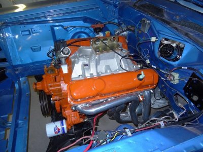

I decided to follow the TTI suggestions. Motor dynoed at 450hp/512ft lbs so I decided to go with the 1-3/4" headers. I think they look great...can't wait to hear what it sounds like (full TTI system with Dynomax mufflers and the TTI slotted tips). 71ChargerMotorInOct2012.jpg
