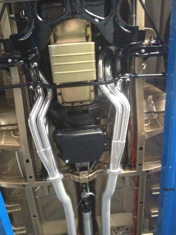

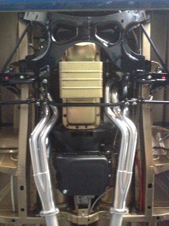

TTI 440-25. Perfect fit. I run the edelbrock Victors too. Also fits right at the crossmember.
Yes Sir. The 77949 head. 2" pipe. 3.5" collector.
If you are using a cable shift stick, run the cable around the right side of the transmission. That way the cable stays away from the pipe, otherwise it could burn. I also run the same K frame as you so you only drop the drag link to drop the headers. And use a mini starter from Mopar

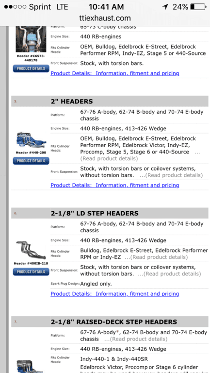

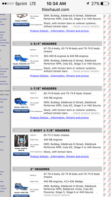

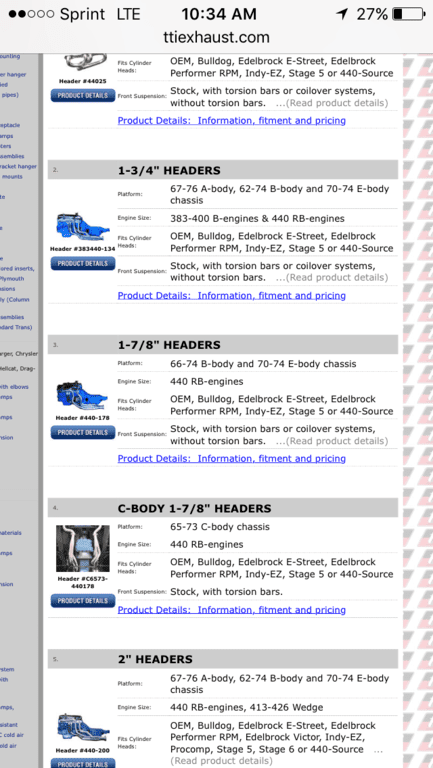

Hmm 440-25 is showing as a shorty header on TTI website, wondering if it could be the 440-200?
Oh yeah. 440-200. It's my intake that is a 440-25. Sorry. And thank you.

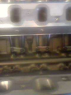

The hughes rockers are working fine, but I'm sure you couldn't go wrong with your T&D's. Have you checked for pushrod clearance yet? Perhaps with T&D they get by? I had to relieve the port walls with these. I used 3/8" push rods from Smith Brothers.
My builder is fitting the heads right now, hasn't said anything about clearance issues yet.
Ok. With the 600 offset Hughes rockers the pushrods interfered with the ports. I had to take meat out of there in every port. Check throughout the travel. It's because of the max wedge port. Good luck.
Ah ok see I got the .725 offset, I don't think I'll need to clearance.
