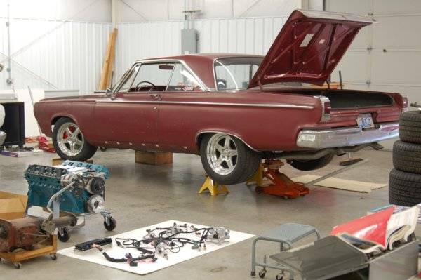

I use a 235/55-17 up front and a 315/45-17 in the rear. Front tires are just generic stuff, rears are Goodyear supercar tires.
