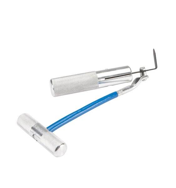

I used this type of removal tool on mine.

Me too. I have never used a wire.
