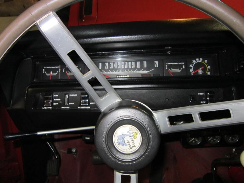

i cleaned mine with solvent and rag. don't submerge it in anything. after you clean it, you can spray paint it the desired color. mine turned out great.
