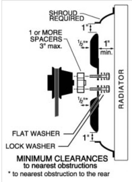

What is the best fan space?
If you are using a fan shroud, center the fan in the shroud opening. Not using a shroud
pulls air from the side of the radiator and is not as eficcient.
Making the shroud looks like can space it anywhere.
Just looking for insight mostly.
However, distance from the radiator is not as critical as shroud being sealed and fan being partially in and partially out of the shroud.
Guess have to figure it out for the most part.
