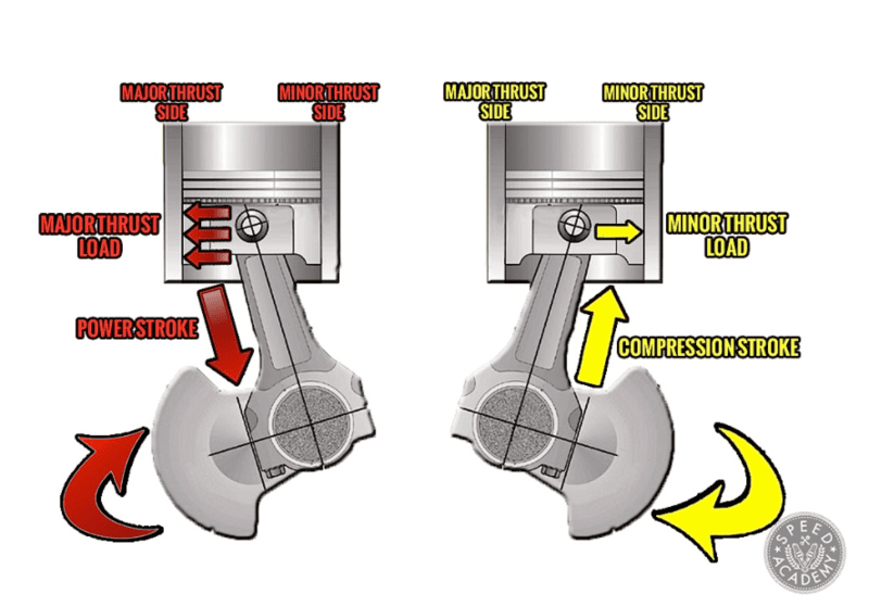

I have seen it said both ways. Which is the correct thrust and non thrust side of the BB mopar cylinder wall?
could you please define Thrust to me. Are you talking about what side of the wall has the most pressure /wear?
The intake manifold side of cylinders 2-4-6-8 and the exhaust manifold side of 1-3-5-7.
Is that what it takes to summon you from the shadows? :bananadance:
Where were you 18 minutes ago?
Front and back of cylinder walls are non thrust the other two sides are major and minor thrust sides. BB mopar major thrust 1,3,5,7 are intake and 2,4,6,8 are exhaust sides.
