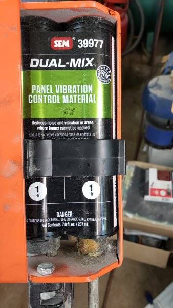

That's not seam sealer, It's a foam that has been replaced by a few way better products. Before you dig out
all of the old stuff, set the hood on two horses and support it where it sits on the car. Next to the hinges and
by the front brace frame where the hood sits on the rubber bumpers. Clean the areas next to the original
spots and apply the polyurethane foam and let it cure overnight, then remove all of the old junk It doesn't
expand or shrink, so it won't move your panels around!
expand or shrink, so it won't move your panels around!View attachment 1348765
I am going to order some, thank you!

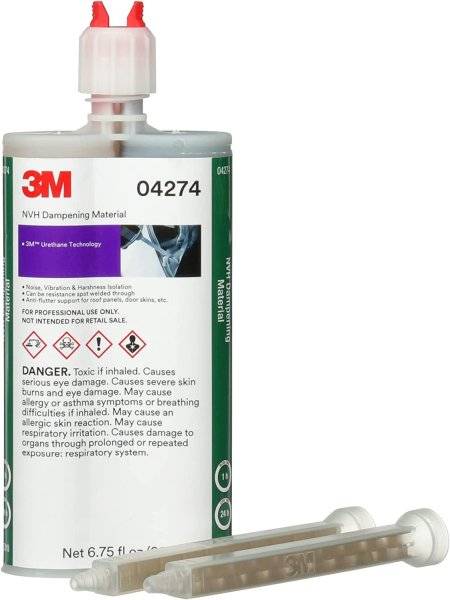

O.K., You also need to get a mixing tip for the material and I borrowed the "calking gun" that the
cartridge that you see above fits into from a local body shop. I have some extra tips if you can't
find them separatly! Let me know and I'll mail you one.
I used the 3M version on my GTX hood and roof skin.
