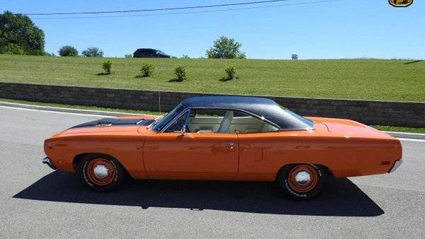

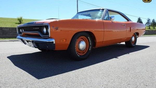

I have a friend with a 70 RR 440-6 that has body colored wheels and hupcaps from the factory and he has a 70 GTX 440-6 with the same.
My Bee has colored wheels and dog dish caps with red ring on them.Google it and you can see the wheels for your car. good luck.
