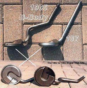

Guys, am building a later model 440 to go where a 400 was originally installed in my 73. It has a 187 stamped pan that looks to be "modified" for a previous installment in its past. Will this pan work...thanks
However, if it fits with the 400 in there, it will fit exactly the same with a 440 in there.

Will pull the trigger on one from 440 Source, the 1001 pan LOOKED like the 971 pan but there is no reference number to a stock pan in the write up. Checking with one other local source here for a used one first. The pan I got with the car was a 187 that had been hammered in pretty good as I guess they got it to fit. Nacho said those were used on C bodies. Anybody got a Melling part number for the pickup needed for that pan...thanks all....

about the pickup oil. I don't think will be really diff from any other center sump oil pan. The oil pan difference between 402, 971 and I'd like to think also the 187 is due the suspension parts, so is molded different, but as far is still on center, the pickup coil should be the same... I think. I never have heard anybody needing to change the pickup oil tube between 402 and 971 when getting a pre 72 BB to mount on a post 73 car
