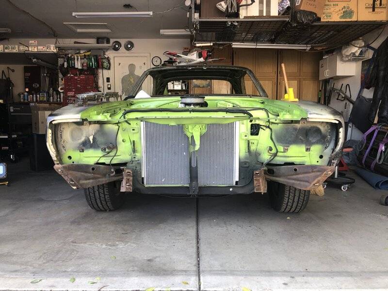

So this is making sense. Here is what my car looks like. Only the engine bay was repainted (not by me) and you can see some black out paint behind the light buckets.
It does appear from the picture that yours is supposed to be blacked out. The green in that area is not a factory spray job, that was done with the headlight buckets in place, probably when the previous owner did the engine compartment repaint. As you can see from Kevin Bisgrove's pictures the factory sprayed that area without the headlight buckets in place.

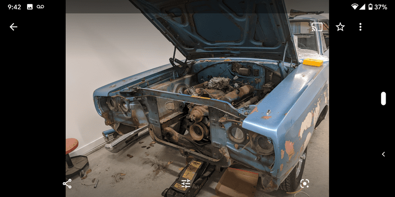

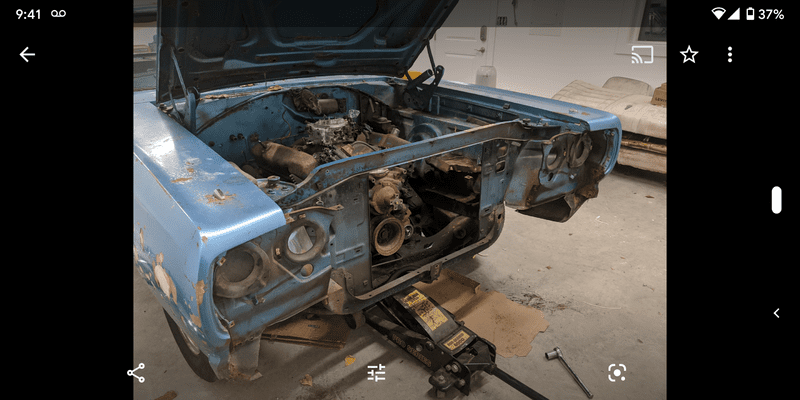

As you see from my photos it is basically the same as Moparfriend posted. Yes only the headlight bucket area was blacked out but the bottom rail as you can see also was.
