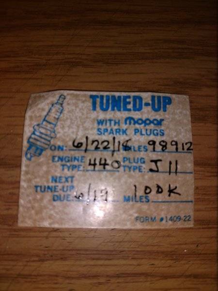

J11 is correct, sir. I buy the Mopar originals (Champion) just for the heck of it. They're plentiful on eBay.
I like using the little reminder decals that come with them:
Yeah, they probably aren't the optimum plug for the engine, but..... :)
