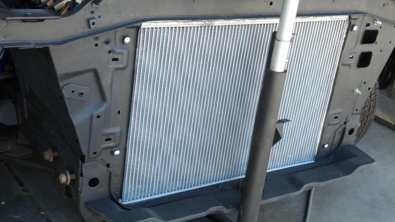

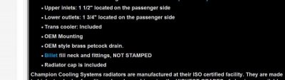

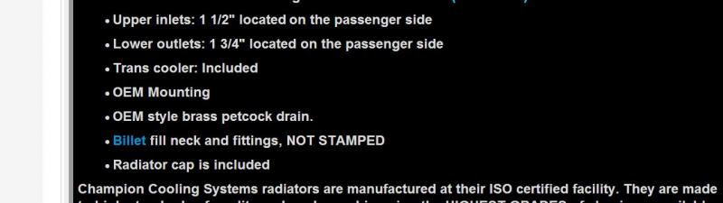

Click on the little tab that says "detailed description" next to "brief description" under the little picture icons on that link you posted............
Hope you didn't order it.......Not the inlet/outlet location you were looking for. Well, 50% right anyways.
