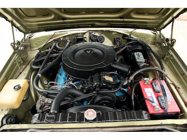

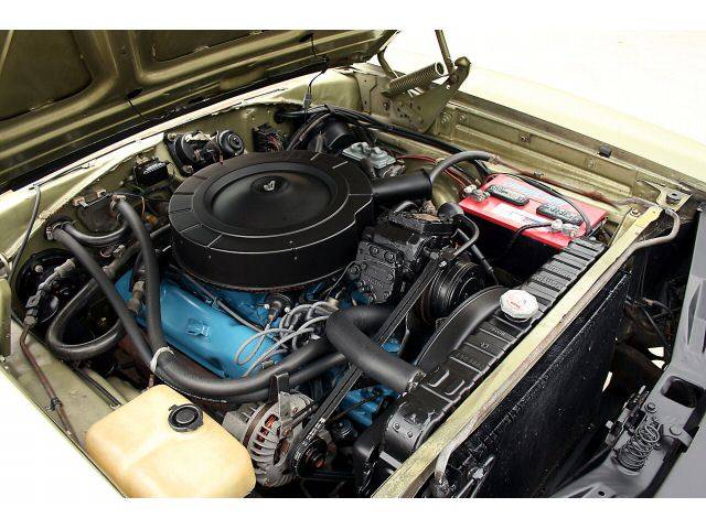

Need to change my very old fan belts on my 383 with a/c and p/s. The two fan belts that work the factory a/c and alternator are Gates 7650 XL, which are supposed to be 65" circumference and 10mm (~3/8") wide. The factory specs say the belts should be around 64.5", so close. My alternator is all the way over toward the firewall suggesting the belts are far too long. I feel they could almost be 10" shorter. What belts are people running (lengthwise)?

Thanks for the advice guys. The car is 250 miles away so I don't have any great photos. I should have done what ARG67GTX and moved the alternator to where it should have been. The alternator appears to be the original unit. Maybe the pulley has been changed. These pics are ones I took years ago (not very helpful). I might just grab some belts of different sizes and see what goes.

Pulley wise it should be a 3 inch. If its 2 1/2 its to small. Alternator is not original by that picture. So it may have the wrong pulley. If its working ok and you need more adjustment just find shorter belts.
