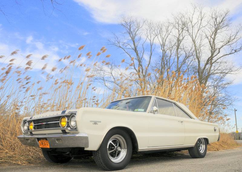

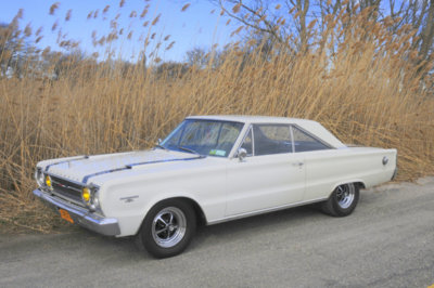

I'm running 255/60-R15 Mickey Thompson E.T.Street s/s Drag Radials on 15"x 8"magnum 500's with a 4 1/2" back space out back. would recommend a 5" backspace if you have the clearance, the outer wheel well curves inward away from the quarter panel. I get a little rub on the drivers side rear with low speed body roll.
225/70-R15 Mickey Thompson Sportsman S/T On 15 x 7 magnum 500's with a 4 1/4" backspace up front.
