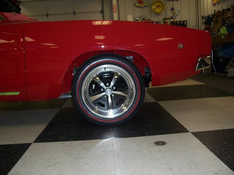

My '68 Charger is fitted with Circle Racing Billet Magnum 500's, 17x7 front, 17x8 rear. Tires are Nitto 450 P225/50R17 front, P255/50R17 rear. I'd like to have a "spare" to finish out the trunk area that would look good and be functional. Should I use a OEM type 15" or 16" steel wheel with appropriate tire, or should I stick to 17"? Any ideas appreciated!

Yup, thanx for the reminder. I've already run into this issue. I'm running 12" rotors with 6-piston calipers from Wilwood and found my 15" Magnums would not fit. Had to replace them with the 17" wheels. The tires where special order from Diamondback (awesome folks BTW) who vulcanized red-lines into the sidewalls for me. I see three options: 1. blackwall same size as rear on simple 17" rim; 2. OEM wheel/tire that I would never use and call AAA; 3. Leave the area open and call AAA. Thanx for the reminders and inputs.
