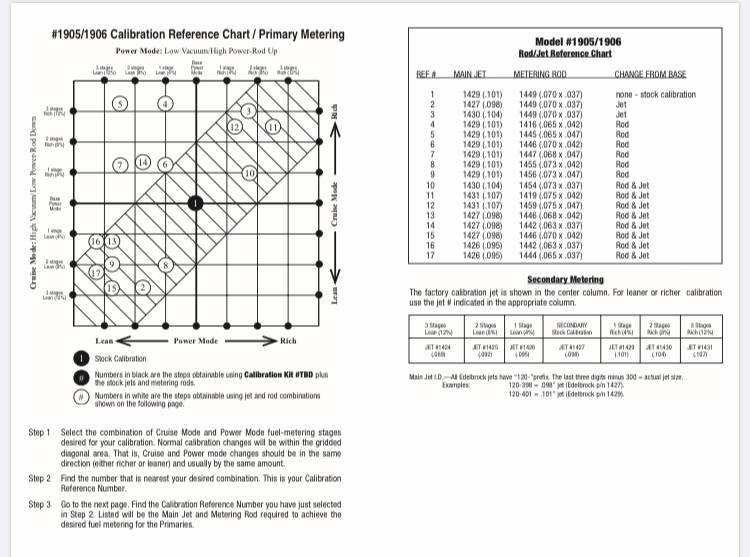

The primary jet/metering rod combo take over fuel duty once it’s off the idle circuit. The primary jet can be reduced and the metering rod enlarged enough to tune the carbs. The secondary jets will also need downsizing for this application. Standard setup is a .101 jet and a 7037 rod. The tuning kits are not in stock but it does look as though individual jets and rods are.
https://www.summitracing.com/search...etering-jets-for-performer-series-carburetors

Are you running a vacuum advance? If not it might improve plug readings. Agree it needs jet/rod changes. If you individual jets rods I'd buy say 2 sizes smaller and 4 sizes smaller. Where ever you start I'd jump 2 sizes at a time to not piss away money.
Hooked up vacuum advance on my crossram by removing plug in manifold and tapping vacuum there. Short run time on it but plugs weren't black.
Thanks Fran I will pickup some jets 2 sizes and 4 sizes smaller along with the correct rods. I have not connected the vacuum advance yet @HALIFAXHOPS (Ray) told me to connect it to timed vac port. I will fire it up again in the next few days and check timing and post where it’s at currently and get some jets ordered up from the summit link @Hemirunner posted above along with the plugs he recommended .

Calcs done for us...
