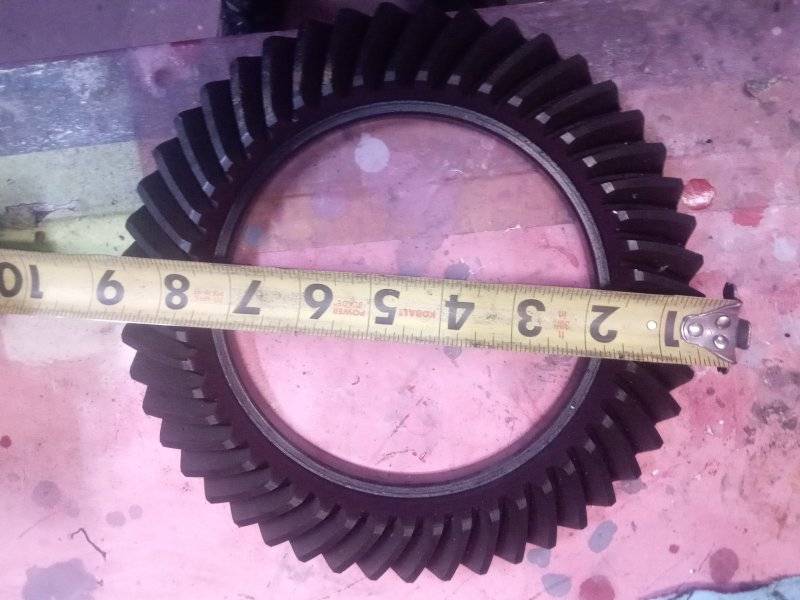

I also measured the back side of the ring gear it was 8 1/4" the front was 8 3/4 which is the correct side measurement? And what type sure grip do I have? Thank you all sorry for being such a pain
It's an 8-3/4. Cone differential.
Here's another 8-3/4:
Measured at the carrier, 7 and just over 3/4"
Measured at the bevel on the back of the ring gear, 8 and just over 1/4"
Measured at the widest point--edge of the teeth-- 8-3/4" give or take a few thousanths
