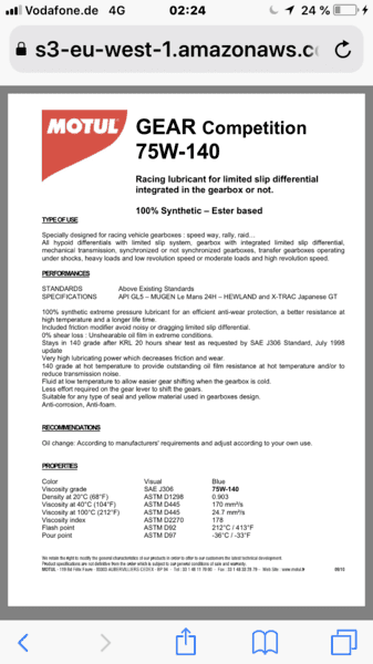

What you think about this oil for my moser Dana 60 with Detroit locker .
Because it’s a synthetic, but not sure they have friction modifier or not inside this oil
I ask Motul directly yesterday , and they say’s there are friction modifier inside the oil.
Therefore it’s not the right oil for my Detroit locker .
Thanks all !
I've stuck with what Moser recommends and offers on their site. I'm not sure if the 140wt is necessary, I used it because I was racing, but later went to the 75/90 later.
Thanks all !
