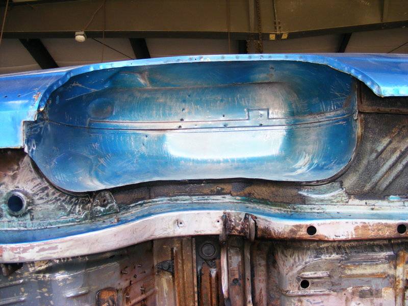

Just got under coating off and wire wheel and sanded under floor pans . What's the best stuff to remove residue before paint . Have wax and grease remover but not be tough enough to remove residue . Thanks

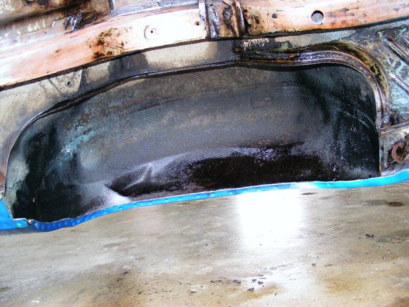

I used Gunk engine degreaser to get all of the tar residue off, and then sprayed
Purple Power degreaser to get everything squeaky clean and then pressure washed it.
