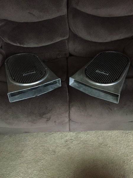

Assuming your 470 is a low deck, the selection of intake manifolds for a 270 head is ... one. And it may not fit under your hood.
With a standard 240 port, selection is a bit better.
Chrysler/Edelbrock 6bbl dual plane aluminum intake, the TF 240s are ideal
My future low deck route.
With a certain item I’m dying to use below.
Thanks rumblefish360. I've seen you post that before.
I will have my current factory 6bbl N96 setup. My hood scoop supporting mechanisms, etc aren't complete yet, and if I move forward with a nitrous spray plate system, (I have already got a Nitrous Express plate to play with) I would mod the hood scoop and whatever other parts would need surgery to make the fresh air/closed off options both work.
My Promax modded Holley 2bbl carbs have given me problems ever since I got them back about a month ago, but I haven't found time to work on a solution. If I pissed away $1,100 on all of the parts and labor, which I honestly think I didn't and they are going to wind up awesome, but if not, a FiTech 3x2 system or F&B direct port injection system is my next move. Either of those 3 options work with the factory air cleaner.
How would TrickFlow 240s affect my hood clearance, if at all?
