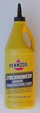

I tied the factory recommended 140 and it was like I put glue in the trans. Went to Sta-Lube 80/90 and it was better, but still had gear clash 1st to 2nd. Then went to the Penzoil Sychromesh and it shifts like butter. I guess each trans may be a little different, but I'm sold on the stuff.

How did that work out for your trans shifting? I see that Ranger 16 tried the Sta-Lube and then switched to the Penzoil Syncromesh.
Interesting that you had to try the first two products only to find that the Penzoil Syncromesh gave you the best results. You may have just saved me the time and trouble to fill my case three times. Thanks.

I was going to call him tomorrow if I didn't get any answers on the Forum. Did you see the response from Ranger 16, tried the Sta-Lube and it didn't shift 100% to his liking, so he tried the Penzoil Syncromesh and it shifts"like butter". Interesting difference a product can make.

No wonder the synchromesh oils works better, it is ATF bases and thin. I wouldn’t use that in and old gearbox.
