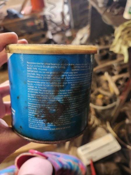

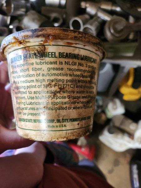

What grease would yall choose? Ngli 2 or 3. Ngli no. 3 is the quaker stake which is brown and thick. Ngli no.2 is the modern crisco consistency.
It is for a 72 charger disc brake k member
NLGI 2 is the grade normally used on wheel bearings automotive wise.
NLGI 3 is heavier, I wouldnt recommend it for wheel bearings, it's a bit much, and will not flow as well. It is a heavier pressure grease; larger, heavy duty bearings--heavy truck etc, good, fifth wheel plates, etc, good.
