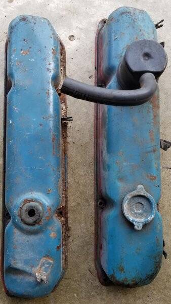

Blue set

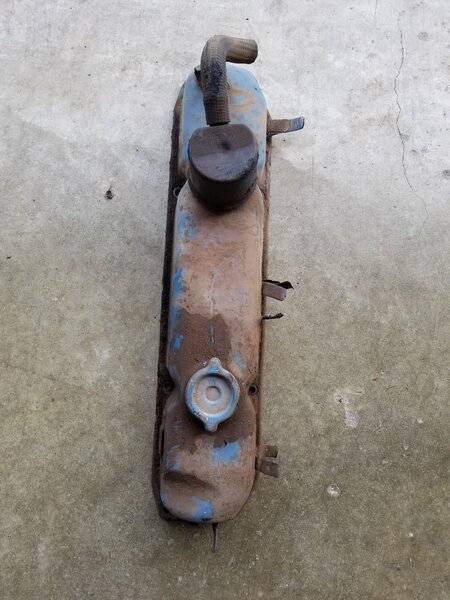

Blue single

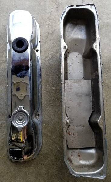

Taller chrome, aftermarket?

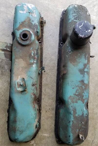

Teal

Out of the 3 blue ones the two with the notch look like 70 covers. I’m sure the experts will be along soon.
Yep the pairs are 70's and the lighter set is '68 with the heater hose clamp, but are they C body covers with the passenger side spark plug tab up on the front of the drivers side cover?
The teal ones do have the long wire bracket that I thought were only on early 6 bolt covers
2nd photo with large bracket is 1967 B &C body 383 and non HP 440. The 383’s in 67 never had HP manifolds and those are the covers they used. 440 HP had chrome covers without that large bracket.

I thought a remembered the teal ones coming from a 68 300
