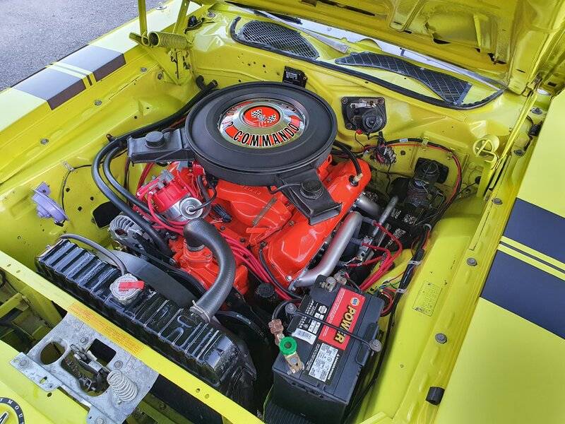

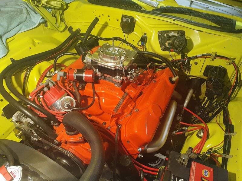

So ive managed to get my very first BB build pretty decent for not spending any kind of big dollars on it. Doing almost everything ( with guidance from a few ppl and from this forum, thank ya! ) myself. Oh boy trail and errors, even ported the 516 - 2.14/1.80 heads and so far it worked as "intended" and im happy.
That thing live's inside my 1971 RR now.

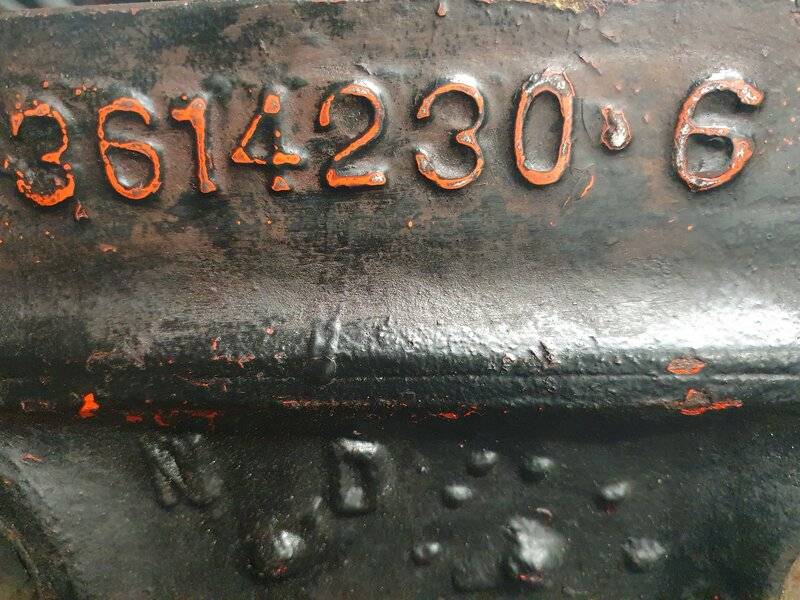

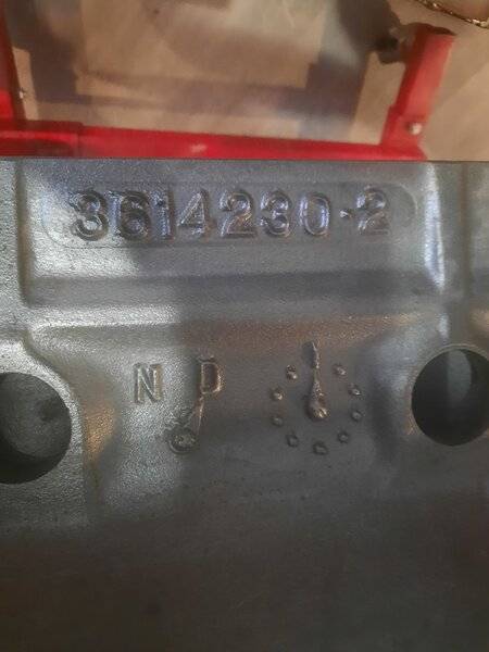

Being a 361 casting I’d do a big inch 500+ big power motor. That block has the really thick main web castings and can handle lots!

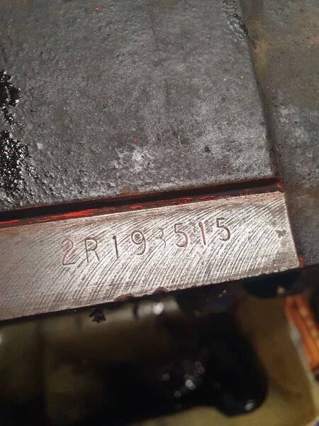

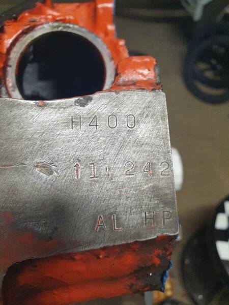

Until you look at the main web you can't say for sure, some do & some don't....

I'll be sure to double check it!

End of the day even without the heavy main webs for a street engine making 5-550 HP you shouldn't have any issues.. The heavy web is important when your making 6-650+

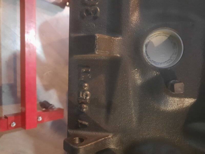

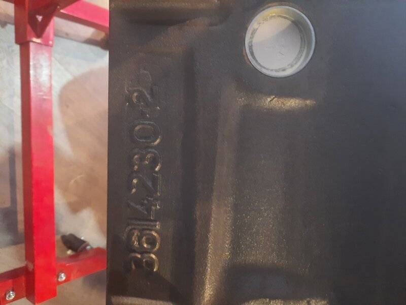

We got a 4.5" crank to fit in our early 400 block for a 542. With 2.2 rod journal we hardly had to grind to clear. If you have a early block like ours the bigger rb crank darn near dropped in. Really impressed with the mains and the overall fit, especially for a 542. Ours dates July 15 71, I don't know when they changes the mains. Most b engine strokers need smaller b counterbalances or you have to grind the block out...which isn't much fun.
View attachment 1079996 View attachment 1079997 View attachment 1080008

As near as we can tell the 230 block castings are the same but somewhere along the way they machined and cast the main area differently. Our 230 has nearly the same crank counterbalance clearance as a 440. We had to machine very little and a crank w rb counterbalances dropped in. I would think if your casting date was similiar it could be identical. Its a awesome block, with the 2.2 pin there is only a small little notch to clear the rods at the bottom of the cylinder walls. It actually turned over w no grinding, but didn't have the .050 clearance needed. We have a bryant billet crank we turned the rods to bbc and mains to b, we have the larger 440 counterbalances and for the pistons to clear we are using a scat h beam 6.7 rod.
You could not use our pistons with the trick flows because they have a step that would contact the head. You would have to spend some dough and get customs. Most shops would say the extra cubes really needs the 270s, and the 4.5 throw will just add stress to the bottom end and talk you into a 4.25. But these 230s have a awesome bottom end with thick mains. The only downside we can see is its a very short piston. We will see how it lasts. We are using a tool steel top ring because it's higher up in the bore then we have done before. Also doing cometic gaskets to lower the compression and help w piston clearance. Another thing I have never seen w a 4.5 throw is our block has room for a 1/2 pickup and it clears! No external pickup needed on this one. Its been a fun one to do. But its not running yet so I can't really recommend it yet...but getting closer by the day! I think its going to be a blast. We have a 4.25 crank in our other b body, going to be interesting to compare.
As near we can tell the 230 block castings are the same but somewhere along the way they machined the main area differently. Our 230 has nearly the same crank counterbalance clearance as a 440. We had to machine very little and a crank w rb counterbalances dropped in. I would think if your casting date was similiar it could be identical. Its a awesome block, with the 2.2 pin there is only a small little notch to clear the rods at the bottom of the cylinder walls. It actually turned over w no grinding, but didn't have the .050 clearance needed. We have a bryant billet crank we turned the rods to bbc and mains to b, we have the larger 440 counterbalances and for the pistons to clear we are using a scat h beam 6.7 rod.
Thanks very much for the info sir, My other block which is cast in 72 not a 230 block worked well with 451 but did show just a hint of cap walk, even with studs on the mains, That's why I got this early 230 block so I can do the 512, Some told me don't waste my time and just get the bulldog block or if Callies will make a "B" block but that's pricey for a street enthusiast and Bulldog has many mixed reviews
