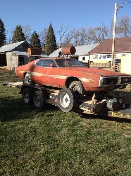

This old hog got painted racing mirrors from the factory!
Ok, finetuning my plans for the 74 clone. If the racin mirrors were an option, I'll keep my single remote mirror. I do the clone as I would have ordered the car. The old hog is all there. Hopefully not rusty to bad. Everything is rusty here in Minnesota
The above red rallye spent a lot of time in Minnesota! It was bought new in Fargo, North Dakota and then went to Minnesota for some time. I think I can save it. .rear frame rails are good as are the trunk and floor pans except for drivers side front pan
If the original car from this thread was a Rally coupe, vice a hardtop Charger, it would not have roll-down rear windows, just like an SE. Only the hardtops had the roll-downs, so SE window louvers could be easily added to the interior and exterior glass. The SE top would be an easy conversion if the owner desired - used chrome strips and Legendary top with correct grain vinyl.
