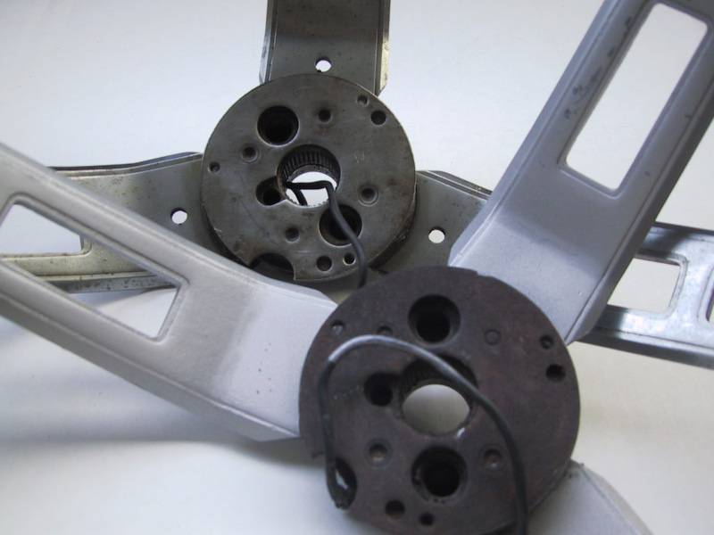

I was wanting a wood grain steering wheel for my 70 Charger but I remember someone telling me that the 68 and 69 ones would not fit the 70? can anyone tell me the difference between them? and what fits and what doesn't fit? Thanks for your help in advance.
70 steering column is bigger in diameter because the ignition switch moved to the column.... 70 has a plastic disc that fills the space.... It attaches with three holes, one in each spoke, you can drill the 68/69 wheel if you can find the filler...
1970 wheel in the back, 68-69 wheel in front
