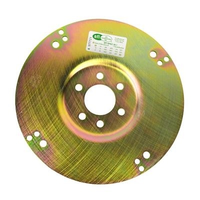

Summit's B&M $101

What's the difference between the Summit B&M and 440 Source, besides the cost?
I read the thickness of the TCI has caused starter to flywheel engagement problems?
SFI certified is only good for so long, so is there any difference between the same flexplate that isn't certified besides they cost less? (I might make a couple of nostalgic passes on occasion)

1. The Summit/B&M & 440 source flex plates appear to be identical.
2. You won't be required to have a SFI-certified flex plate unless your car is really quick (don't know the exact NHRA rule.... something like over 135mph or under 10sec. in the 1/4 mile in an automatic with floorboards).
3. The Jegs/TCI flex plate "might" be lighter looking at its shape.
4. Based on your description of use, I would stay with the stock flex plate unless it was bent or cracked (check near bolt holes).

Not an expert on this subject but just ordered a new one myself similar to the original one. I wouldn't use one of those stiff, SFI (not-so)flex plates unless you are dialing in your transmission case to within a very few thousands alignment with the crank. Those things won't have much flex to them and if the alignment isn't good and I would think you have a good chance of picking up vibration and possibly wearing the transmission pump bushing and converter hub. Unfortunately the only way to dial in your transmission case is to first remove it and completely empty it out and bolt it back in position.
As someone here recently said to me - there is a good reason they call them flex plates.

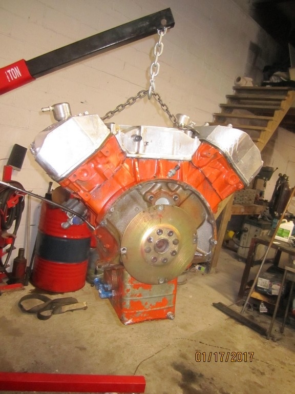

Everybody here is right. You probably don't need a new flexplate and you probably don't need a SFI rated one. But......You've got everything already torn down and if it's something as simple as piece of mind, why not?

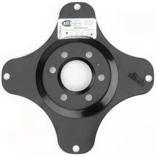

I received an original style TCI flexplate 145600 today from Summit which is going to have to go back. It's not like the description or picture in their ad. The 10 inch bolt pattern is drilled for 3/8 inch bolts. What Mopar uses 3/8 inch converter bolts???????? If I had a HD or Hemi converter I could ream them out to 7/16" but mine are 5/16 inch. Nuts - beware.
I read some reviews of people receiving flexplates with the wrong size holes. Also a couple of customers had starter engagement problems with the thicker oem looking plates...

I used the B&M SFI plate.

The TCI has two bolt patterns on it also (although the Summit product picture and description only says it has the small bolt pattern). It has 11 inch with 5/16 in holes and 10 inch with 3/8 inch holes. I repeat - has anyone seen a MOPAR converter with 3/8 inch fasteners?? I'm beginning to understand the rap TCI gets from some members.
I'm thinking the 10" 3/8" fasteners would be for aftermarket torque converters?
The Hughes TQ I just received is 5/16-24. I believe if you go for a HD or high stall TQ they will usually drill it for 7/16 bolts which is what was used on the 60s Hemi. I've spent weeks looking at torque converter manufacturers and haven't notice one using 3/8 inch hardware. But, if you still want a new flex plate I did find this one that looks like a stock replacement with 10 inch bolt circle and 5/16 in holes. Also it's cheap - under $20 and available from Summit, Advance Auto, Amazon, etc. This would be for an 11 converter - not the bigger 12 inch.

Well scratch Advance - the APT flexplate that came in was the same thing that Summit sent (except lacking paint and cheaper). It was dual bolt pattern with 11 x 5/16 inch and 10 x 3/8 inch - so back it went.
Mancini Racing appears to have the correct 10 inch bolt pattern flex plate which I'm trying next. Keeping my fingers crossed.
