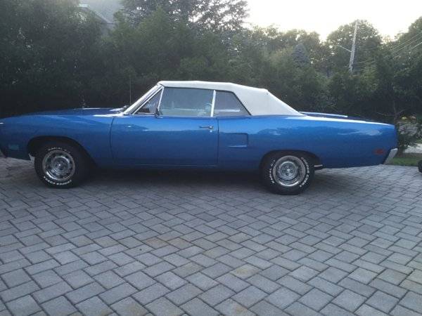

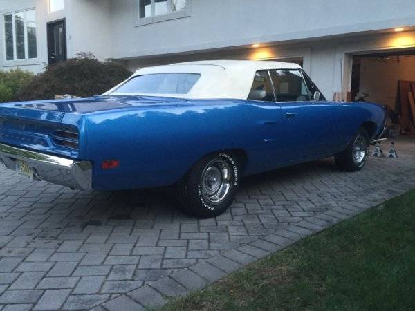

I have 15x7 with 235/60-15's in front and 15x8 with 255/60-15's out back. There is prob a little room left to put 275's in the back, but I'm happy with the 255's.
Beautiful car NJRR! Hope mine can look like that someday! Do you know anything else about the wheels you are using offse/back-spacing/hub size?

Thanks. IMO, 70 Satellite/Roadrunner is the nicest B-Body !!!!
My fronts have 4.25" backspace, rears 4.5". I'm not sure what the 90mmHUB reference is.
