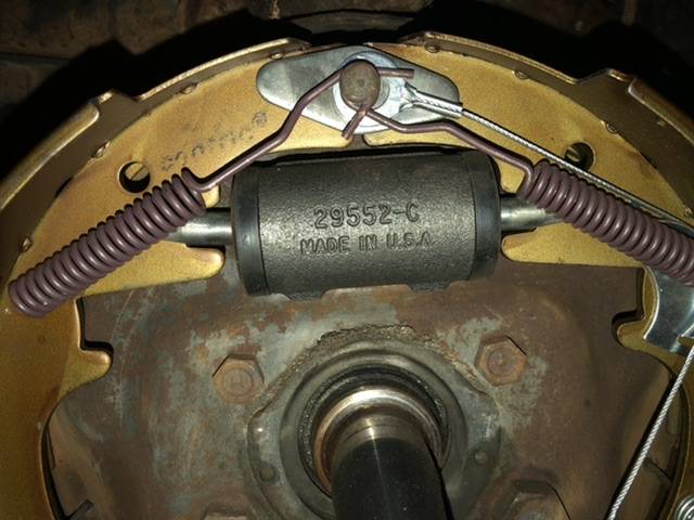

I usually just replace these with new or remans from the parts store. I think I'll save these and redo them myself. The stamping on the cylinder speaks for itself. Any heads-up or pointers I need to be aware of?...this will be my first time rebuilding wheel cylinders.

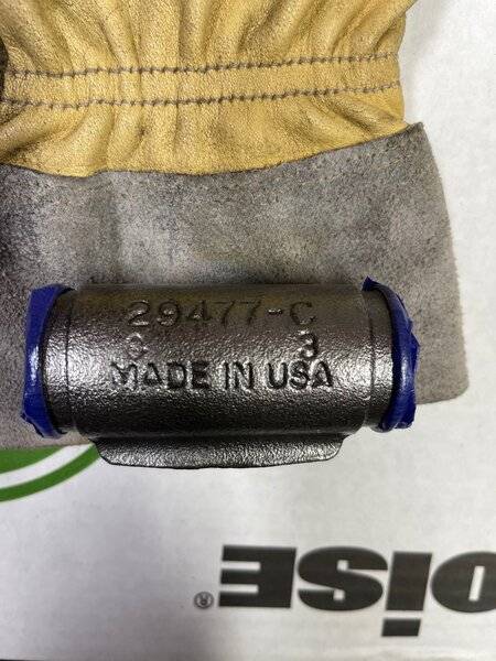

I bought rebuild kits too, but every one had pitting in the center bottom. All the pitting was probably not in the seals travel, but I decided to use new ones instead. The only reason I wanted to rebuild them is to keep all the same type bleeders.

I ordered my rebuild kits on Rockauto and actually received nos Raybestos kits that were made in the USA.
As OKDart said, the bleeders on the originals are larger than replacement cylinders and preferred.
