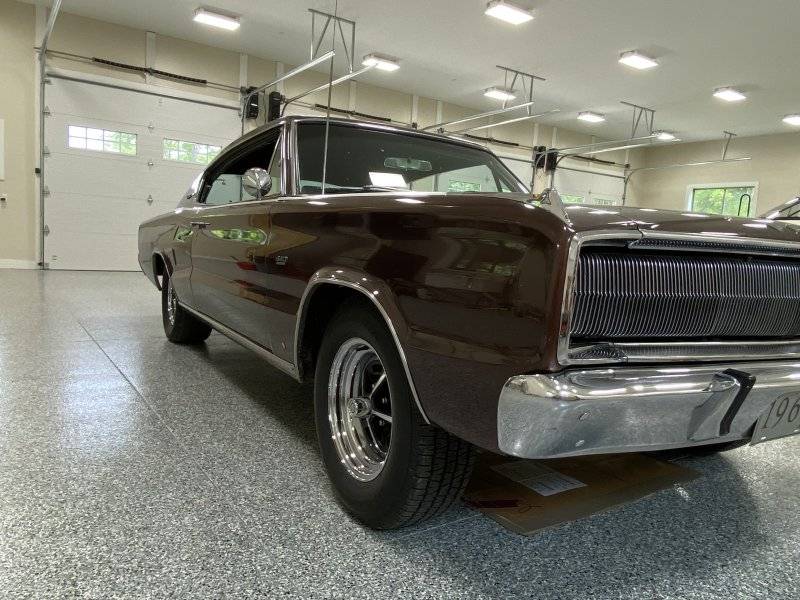

I go same size rims on all four corners, 15 x 7. 225 or 235/70/15 on all corners and occasionally 255/60/15 on the rears.
Couple pics.

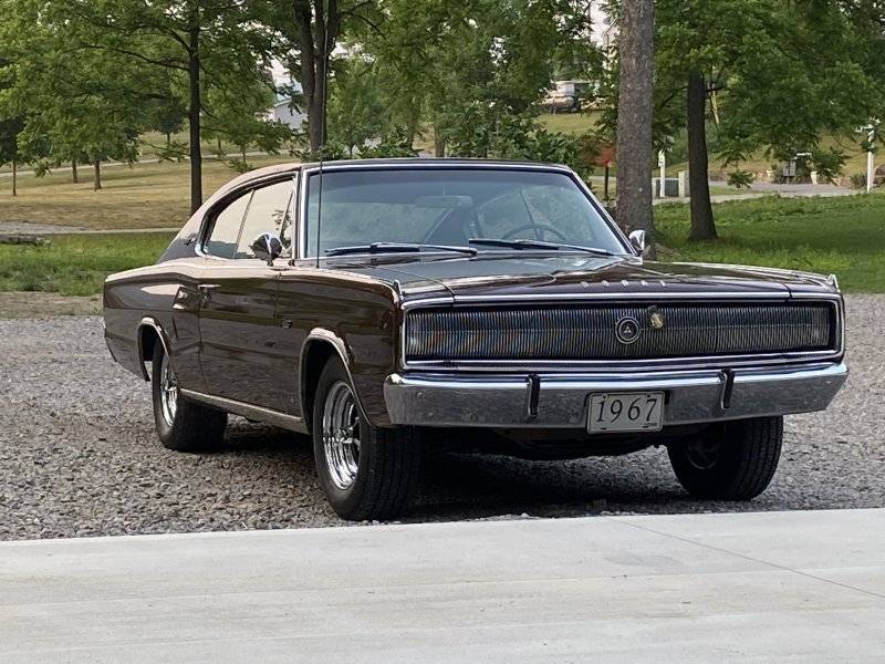

I have 215/70 on 15 x 7's on the front of my '67 R/T, and 235/70 on the rear. I find that anything fatter than 215/70 on the front rubs on frame rail at full turn. Another place to watch for interference with a taller tire is leading edge of front wheel well, as wheel is turned through it.
