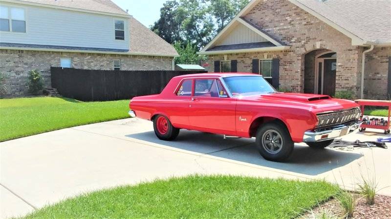

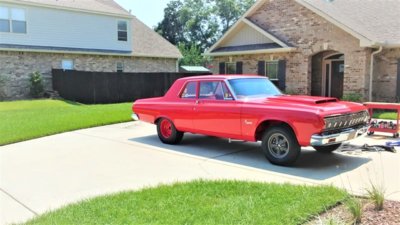

Probably right. Go with these. Vintage V etmags. cleared my disc brakes.

One of the best looking wheels out there that is the closest to the old magnesium wheels. Did you paint or coat these wheels with anything? The wheels in your picture have that great aged dark look of a magnesium wheel in lieu of the ET Vintage V wheels new shiny finish.

Thanks Button pusher. Yes just scuffed em up a little and sprayed with Cast Blast paint. Love em. You cant go wrong.

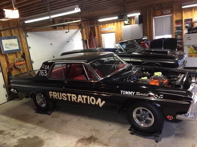

Another vote for ET III Wheels. I left the edges polished and hit the center with "Cast Blast" from Eastwood. The paint I used has more clear in it than I like. I may shoot them again with a flat, dark grey. The wheels on that red '64 Plymouth are beautiful. The car is second to none! LOVE IT!!

Thank Frustration! Your rides are not too shabby either! Lol! I actually didn’t use Eastwood cast blast. It was another brand. I’ll post a pic here shortly. It is flat and I really like the look. Thanks again for the compliment. Hope you get the look you want!
