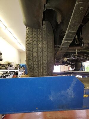

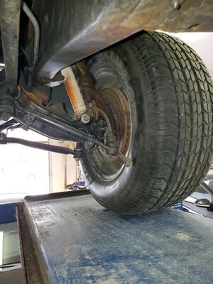

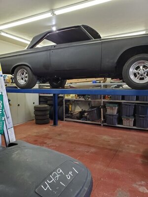

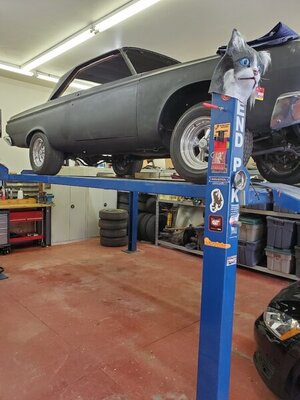

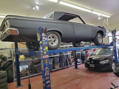

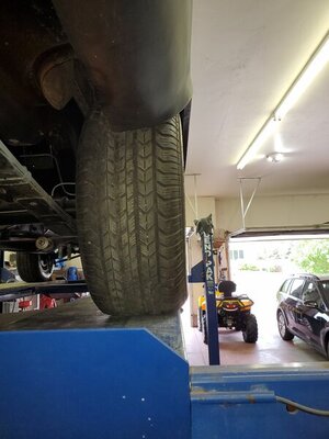

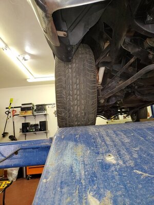

Went ahead and bough and mounted on car since I posted earlier. Turned out they were 295 60 15 rears and 275 60 15 fronts. They fit! Need to buy the proper 1/2" lug nuts and offset washers. They were on a Chevelle some years ago and he replaced them. He's cleaning out his storage and they had to go. I'm attaching a couple pics.

looks good!
Those front tires may not fit with and engine in the car and it sitting down at ride height.
275/6015 is a big tire for the front.
Hmmm....looked like they had plenty of room in the hole and for turning too,but won't really know until the weight is on and ride height is set. I hope you are wrong.....may be a while before we find out.
