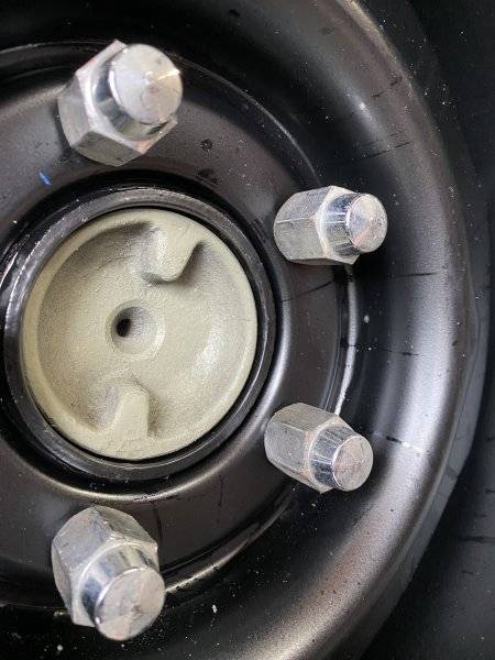

So I got some wheel vintiques 15x8 OE style wheels from classic industries and when I got tires mounted the guy told me the rims were bent (I believe this was noticed on the wheel balancing machine)
After looking at them closer the center bore looks like it was stamped incorrectly on both wheels (pics attached) from one side to the other the lip/flare is uneven. The wheel was mounted on the balancing machine on the center bore and tightened with a center nut, I am thinking if the wheel was mounted with a lug centric mount it would not be bent. It seems like the center bore really isn't that critical with conical lug nuts.
I'm trying to find a tire shop with a lug centric balancing machine but wanted to see if anyone else has ran into this.
Jack up both rear wheels (jackstands too!), put it in gear, let it idle, and take a look. If they wobble, return em. If they don't, take it to someone else to balance. Ignore tire movement, look closely at the wheel.

You can also set another stand right in front of the wheel. Take a small stick or piece of molding rest it on the stand and slide it towards the rim edge. You'll be able to see the runout.
If the center hole doesn't fit over the center of the axle flange, gets stuck, then that might be your problem. If it does go on without any interference then the center of the wheel is probably bent. Send it back. Most won't take them back if they have been painted.

it's my understanding that those "63" wheels use salvaged centers with new rims. i bought a set a few years back. one bent or didn't have the center welded in correctly. always spin check anything those guys make before mounting a tire or painting a wheel.
Can only be balanced with lug centric, but ones I received with no jigged correctly and the bend spoken of was lowered during assembly, poor quality control, plus once you mount tires , they won’t take them back! Maybe classic will but wheel vintiques will not ! So bought replacement wheels from classic ckd runout and if were poor quality sent them back till I had finially received four that were at least usable!
