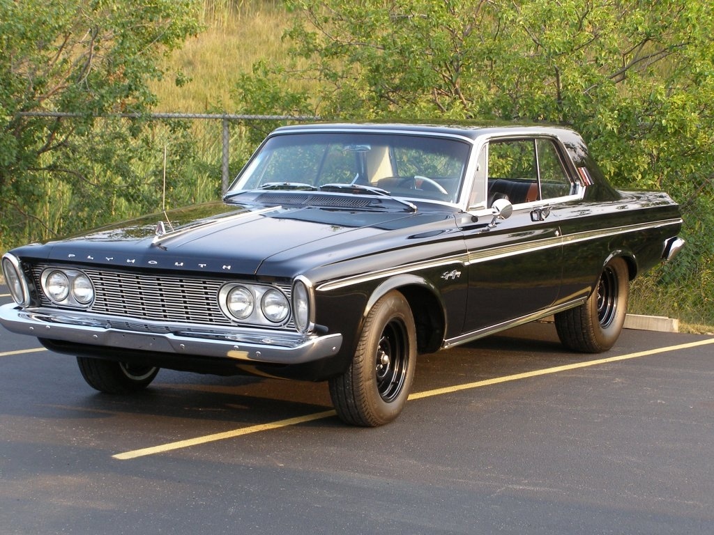

I have Keystone Klassics on my 63 Fury they are 15x8 with 4 inch back space the tire is 275-60 the fit is great

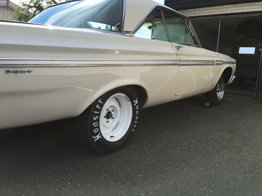

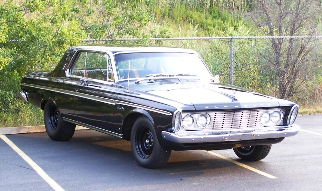

Fitted Mopar standard steelies on my '64 sport fury stock rear axel and stock wheel wells. Tire: Hoosier 26x9 15". Wheel 15x8" 4,5" backspace. Fits really good!

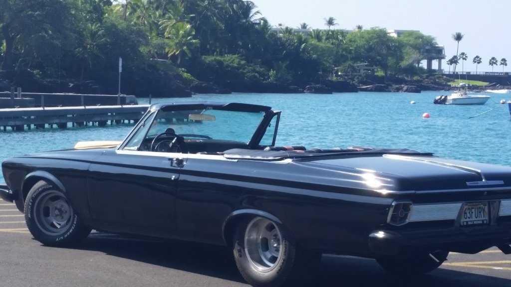

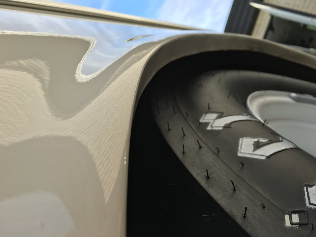

N50 X 15's on my 63. so that's 12 inch's of meat . but I did put an A body rear end under my Vert. Also running with a set of M/T . same size

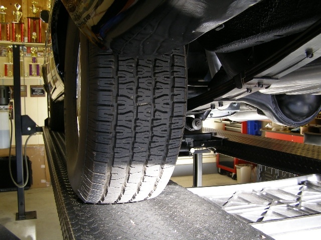

Ron, On both my '63 Sport Fury and '63 Fury I run the largest tire I have found. When I say largest I mean both in diameter and width which I've found to be the 285/70R-15. For a street tire that is 31"x 11.5 on a 7x15 wheel with 4.5 back space.

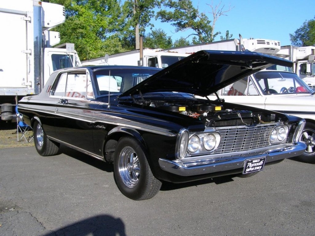

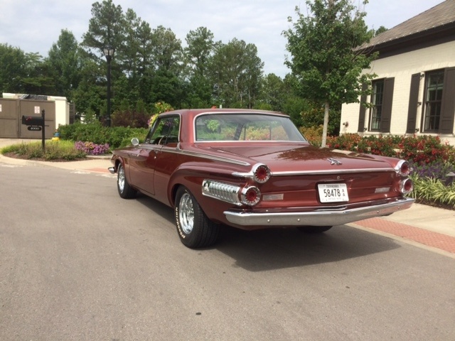

I have 30x9s on my 62 Dodge with stock wheel wells...
I will say my wheelwells on my 63 Sport Fury will fit more tire then my buddies 65 Coronet will. I have everything in stock location and I run 30 x 9 tires in the rear with plenty of room to spare. Ron

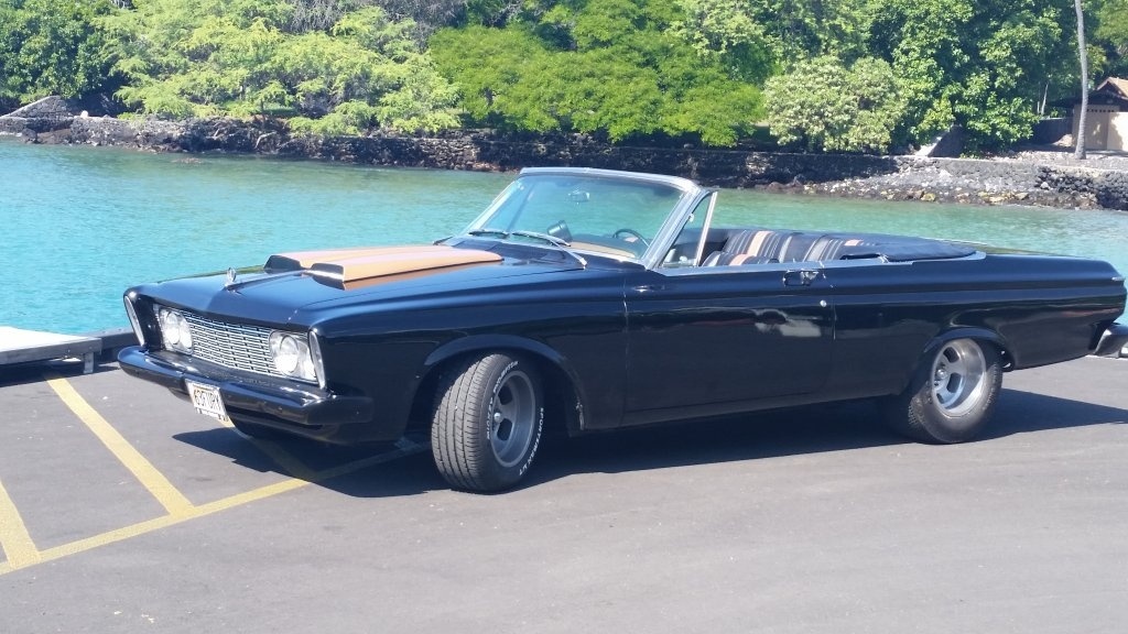

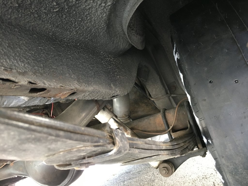

Just swapped the rearend or is the springs relocated to? Minitubed? I would like to fit a 10"x15 wheel with 3" backspace in but don't know if it fits without minitubing and move the springs.
I have 15x8 with 4.75 backspace, couldn't go any bigger backspace without tyres hitting springs...
I'm going to try 275/60/15 on a 15x8 wheel with backspace of 4.25" on the rear of 62 Polara next week. The backspace is somewhat concerning but only option offered on the wheel I wanted.
If no fit then my option will be 255/60/15.
I did the 275 on the rear and no issues. It's close but makes it. I have about a half (1/2") inch between top of tire and quarter panel.
A body rearend and move spring perches . NO Mini Tub
