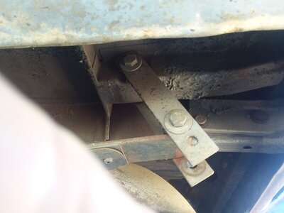

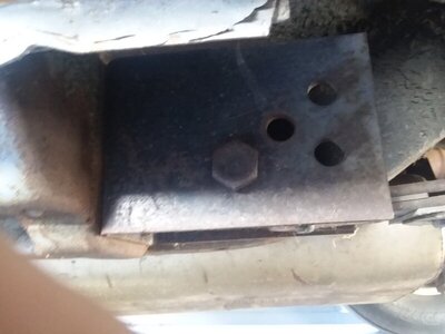

Pics are my shackle, hanger, and a pic of a stock 62 savoy location (not mine)

My 65 Dodge rear shackles on the ground. SS spring 20" front segment have 2" extra length front perches. 65 Dodges had 21"(I believe) front segment so my wheelbase is 1" longer. Have correct perches but not on car.
If you change your wheelbase, you have to change your driveshaft as well. There are separate hangers for Dodge and Plymouth, due to the 1" difference in wheelbase between them. The body structure was the same; the wheelbase change was accomplished with the different length front spring hangers. Those Mopar Performance front spring hangers for mounting the 2" shorter front segment Super Stock springs (A-body springs) were engineered for 1966 and up B-bodies and E-bodies. To put S/S springs under a '62-'65 B-body, you must modify the hangers by drilling new holes 1" short of the factory holes.
I had put S/S springs under my 1967 R/T using the Mopar Performace 2" longer hanger kit. I then found that the stock 1967 Dodge front hanger was the right length to install S/S springs under my 1964 Polara. The mount holes are out 1" farther on the 1967 Dodge hangers than the 1964 Dodge hangers. This makes up the difference between the 21" front spring segment on the1964 spring and the 20" front segment S/S spring.

I drilled mine in a vertical mill against a stop, so both sides were identical. Necessary to keep the rearend square in the car.
Also, if you are using the extended hangers and redrilling new holes, you can put them higher or lower than stock too. I placed mine lower for two reasons. It gives more body height for tire clearance, but primarily I wanted to change the instant center height, to reduce the ridiculous rear body lift I had with the stock springs.
