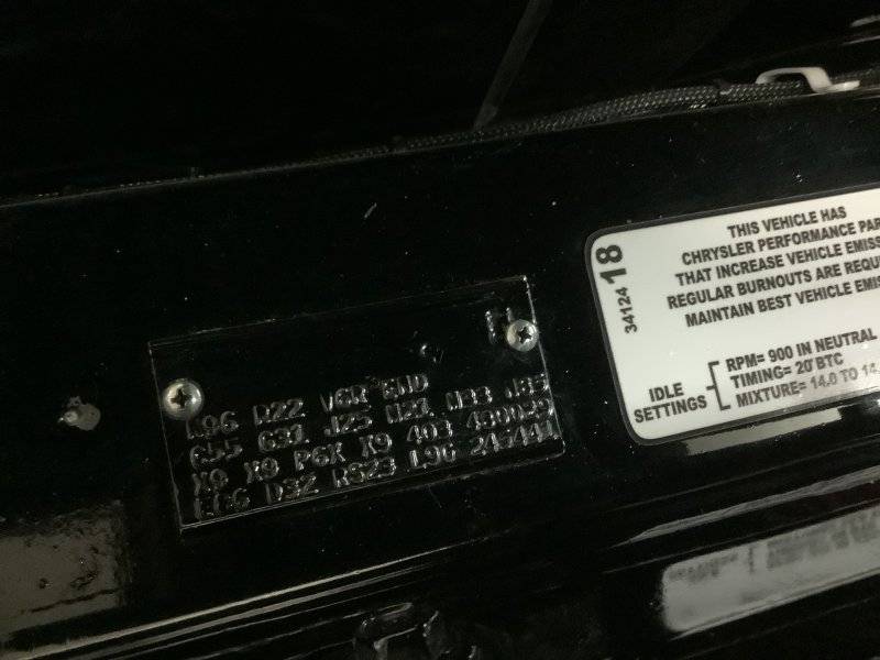

Your fender tag will tell you what was originally on the car I believe, but if you want to change it up, the options are endless. For a 'period' look, Cragar S/S, aluminum slots, Keystone Klassics or TorqThrusts would be good. Go to a 15 for both appearance and tyre selection. 7s are no prob, you can do 8s in the back Im pretty sure with a 4.25 backspace. I believe a 275/60 will go in back if youre careful ; check the Tire and Wheel section - many threads therein.

I disagree on the black wheels as well as the fender tag showing what wheels and tires were originally on a car.
